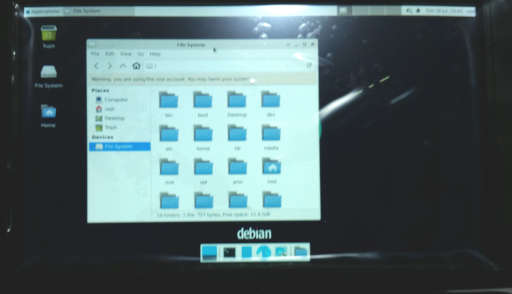

Ok, well after a *lot* of poking around and a lot of work I managed to get xorg going. Not much works for example the nubs don't move the mouse or anything but after trying to figure out how to compile this I eventually got xorg showing something. Took a lot of work though mind you to work out what I needed.
The xorg.conf config on that page I linked too is needed as well.
