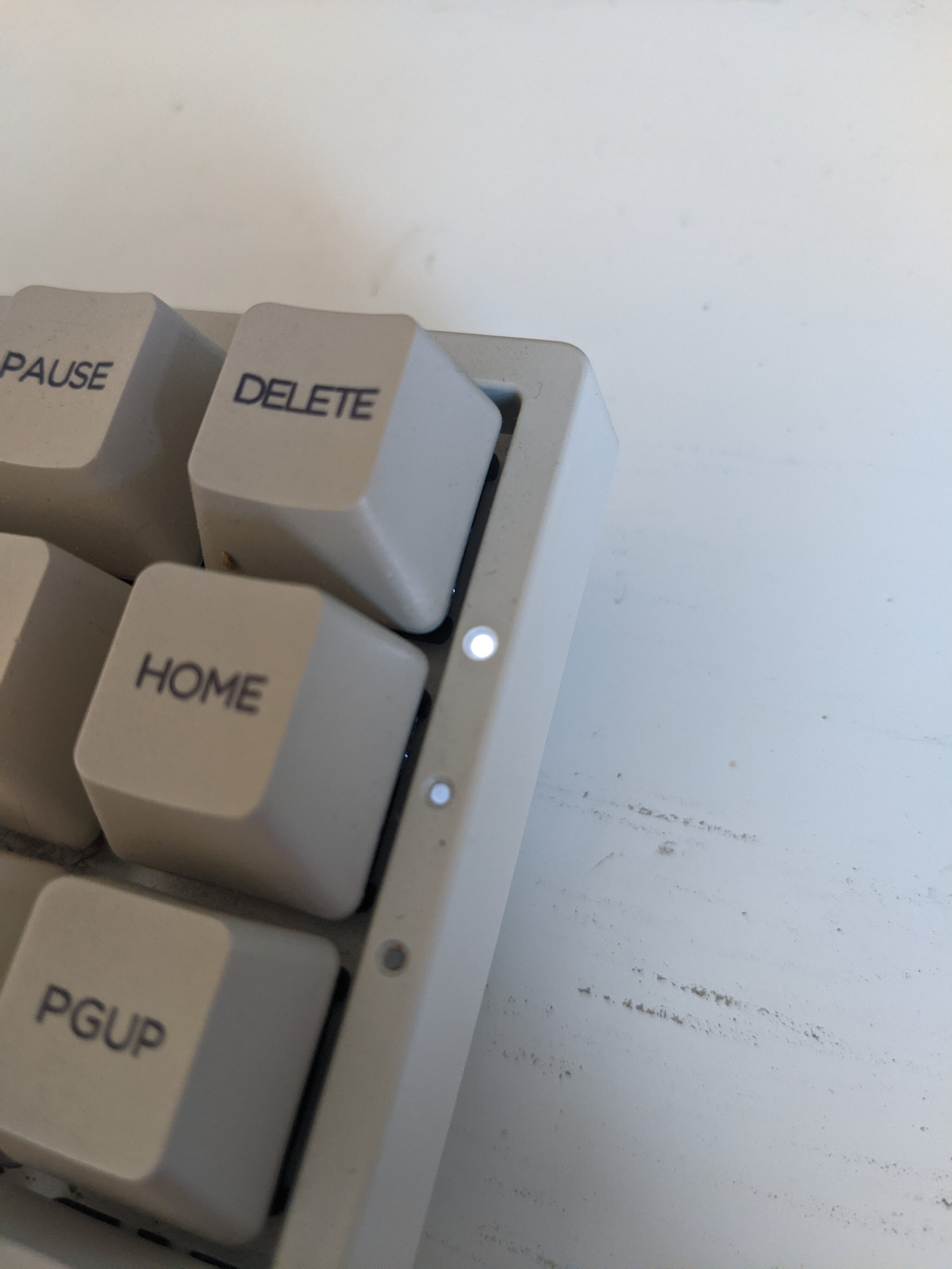

so i found my old script -rwxr-x--x 1 w w 1.5K Nov 17 2001 ledmail*
turns out it uses the setleds command which... exists on my current system!
So i am now wondering if my script will still work after 20+ years of updates, distro changes, hardware, etc. Still work between Mandrake 7 and Ubuntu 20.10?
Would be very cool....
Well it didn't work out of the box, two changes were needed:
1. correct regex to parse setleds output
2. call it inside a sudo sh. i think the /dev/tty1 permissions have changed over the years or somthing sudo sh -c 'setleds -L +caps < /dev/tty1'
But yes my customisation is workable after many many system updates.

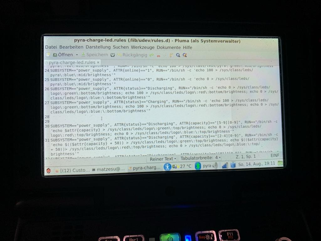

To use the lid as a battery indicator:
Code:
SUBSYSTEM=="power_supply", ATTR{status}=="Discharging", RUN+="/bin/sh -c 'echo 0 > /sys/class/leds/logo\:green\:bottom/brightness; echo 100 > /sys/class/leds/logo\:red\:bottom/brightness; echo 0 > /sys/class/leds/logo\:blue\:bottom/brightness'"
SUBSYSTEM=="power_supply", ATTR{status}=="Charging", RUN+="/bin/sh -c 'echo 100 > /sys/class/leds/logo\:green\:bottom/brightness; echo 100 > /sys/class/leds/logo\:red\:bottom/brightness; echo 0 > /sys/class/leds/logo\:blue\:bottom/brightness'"
SUBSYSTEM=="power_supply", ATTR{status}=="Discharging", ATTR{capacity}=="[5-9][0-9]", RUN+="/bin/sh -c 'echo $attr{capacity} > /sys/class/leds/logo\:green\:top/brightness; echo 0 > /sys/class/leds/logo\:red\:top/brightness; echo 0 > /sys/class/leds/logo\:blue\:top/brightness'"
SUBSYSTEM=="power_supply", ATTR{status}=="Discharging", ATTR{capacity}=="[2-4][0-9]", RUN+="/bin/sh -c 'echo $(($attr{capacity} + 50)) > /sys/class/leds/logo\:green\:top/brightness; echo $(($attr{capacity} + 50))> /sys/class/leds/logo\:red\:top/brightness; echo 0 > /sys/class/leds/logo\:blue\:top/brightness'"
SUBSYSTEM=="power_supply", ATTR{status}=="Discharging", ATTR{capacity}=="[01]?[0-9]", RUN+="/bin/sh -c 'echo 0 > /sys/class/leds/logo\:green\:top/brightness; echo $(($att{capacity} + 100)) > /sys/class/leds/logo\:red\:top/brightness; echo 0 > /sys/class/leds/logo\:blue\:top/brightness'"
SUBSYSTEM=="power_supply", ATTR{status}=="Charging", ATTR{capacity}=="[0-4][0-9]", RUN+="/bin/sh -c 'echo 0 > /sys/class/leds/logo\:green\:top/brightness; echo $(($attr{capacity} + 50)) > /sys/class/leds/logo\:red\:top/brightness; echo 0 > /sys/class/leds/logo\:blue\:top/brightness'"
SUBSYSTEM=="power_supply", ATTR{status}=="Charging", ATTR{capacity}=="[5-7][0-9]", RUN+="/bin/sh -c 'echo $(($attr{capacity} + 50)) > /sys/class/leds/logo\:green\:top/brightness; echo $(($attr{capacity} + 50)) > /sys/class/leds/logo\:red\:top/brightness; echo 0 > /sys/class/leds/logo\:blue\:top/brightness'"
SUBSYSTEM=="power_supply", ATTR{status}=="Charging", ATTR{capacity}=="[8-9][0-9]", RUN+="/bin/sh -c 'echo $attr{capacity} > /sys/class/leds/logo\:green\:top/brightness; echo 0 > /sys/class/leds/logo\:red\:top/brightness; echo 0 > /sys/class/leds/logo\:blue\:top/brightness'"
Add this to /lib/udev/rules.d/pyra-charge-led.rules
You could create another file in the same directory, then it wouldn't get overwritten if an update replaces that file.
You'll need to run sudo udevadm control --reload to update the rules.
I haven't tested the low point. Hope it works. It is also very slow to update from plugging in and unplugging. Not sure if that is a udev thing but probably the state of the charging driver.
Summary. Bottom logo will be red discharging, yellow charging.
Discharging, top goes green (99%-50%), yellow (49%-20%) then red.
Charging, top goes red (0-49%), yellow (50%-79%) then green.
Happy to hear comments about whether running multiple commands from a RUN section is ok.

How do I apply this script? I found it impossible the way I thought it works:
Do I add the script under the existing script on the file? Do I make a new file and just put the script in? I allready copied the original file to a safe folder, but I can’t edit the file in udev..
To edit the file using pluma, you will need to use
Bash:
sudo pluma /lib/udev/rules.d/pyra-charge-led.rules
It might not work if your DISPLAY variable is not set automatically under root. (on my Debian I have kate, and it dies with "Executing Kate with sudo is not possible due to unfixable security vulnerabilities.")
to activate, use "sudo udevadm control --reload" or just reboot.
note of warning: You should put all custom stuff in /etc not in /lib (disclaimer: I don't have a Pyra in my hands to verify this, but if it's Debian, then this rule should apply)
/lib/udev/rules.d/ Contains default rules files. Do not edit these files. /etc/udev/rules.d/*.rules Contains customized rules files. You can modify these files or create them. However, files with identical file names replace each other. Files in /etc have the highest priority and take precedence over files with the same name in /lib.
* make sure the files ends with .rules and not .rules.txt
* there is this udevadm test command, but I'm too noob to give instructions on how to use/test.
Ok so this means it’s loads now the unmodified File in etc instead of the modified in lib..
so I should try to modifie the file in etc ..
I allready made the mistake using the file in lib..
It’s now looks so when I have the os running, the lid closed and the charging cable in:
