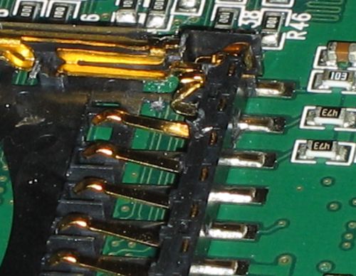

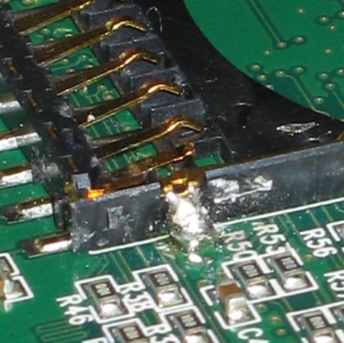

I purchased a second GP2X for my wife but the SD card wouldn't "click" into place, there was no spring-ie to it when you slid the card it. The card would go in as far as it does with my GP2X. With any SD card installed, it would not boot up to the menu screen. Without the a SD card in it, it would boot up and she could play the Vektar game in NAND memory.
Two issues.... first the no latching/springy of the SD card. If you look down in the SD slot, on the right side is a thin black plastic finger that normally the card presses against as you insert it. This black plastic finger is spring loaded and works like a clicky ball point pen. Her unit was in the down position. I was able to slip a thin screw driver down into the SD slot and depress the black plastic finger down a little and then it unclicked and came up. Now the SD card will click in and lock down, then depress the SD card and it springs up. Weeee.... still won't boot up to menu screen with SD card in it.
The other issue was a bent contact pen, in my case the one on the far left side was bent into a "Z" shape.
With a fine tip pair of needle nose pliers, I improved it:
Sadly, the metal doesn't take to sharp bents very well and the downward tip of the contact snapped off.
I'll warn everyone.... this repair was a bit of a pain in the butt to do. I'm not going to go into detail because quite simply, if I you can't figure out how to do this on your own, it might be best to not try. It took me over an hour to do this.
The SD card now pops in and out without issue and the system will boot up... and I notice the LCD screen is a dud... something I had kind of wondered about from the start. On green boot upscreen, there is says "GP2X" I could see faint ghosting lines running across the screen. It has always done that. Then when I boot it up for the first time with the SD card in it, I load up the game Mraid game, you can see ghosting strips across the screen, real bad on high score screen. :angry: Already tried firmware update. Mym GP2X is clear as a bell.
Hope you enjoy the pics and if anyone knows of a fix for the screen ghosting, I'd like to know.

Having had a thread of my own with my GP2X displaying the same symptoms, I finally got round to fiddling with telnet this afternoon, and it turned up the CMD17 error described further up in this thread. I had looked at the pins before but couldn't see any problems. Of course, once I knew that it was the left-hand pin - damn, it was bent...
So, I used to have a warranty, but I opened the thing up. I will repeat penclnck's advice - if you have no electronics background, DON'T FIDDLE. Send it back. :p Anyway, I managed to wroughly force off the SD card cover and spent the next hour or so trying to slowly bend the pin back into shape.
Once it was all back together, the SD card slot worked without any problems. :lol:
One problem - I managed to ping the spring for the SD card spring mechanism somewhere. So I don't have spring loading any more, but at least the damned thing works!
