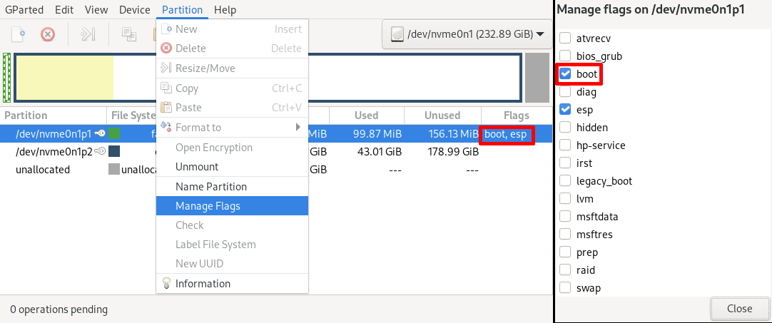

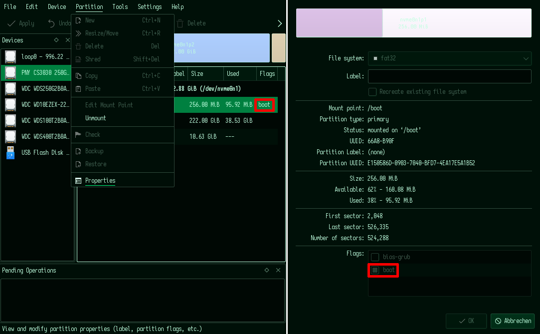

1. The Pyra does not boot if there's an SD Card in the left slot
The left SD Card slot has the highest boot priority. The OMAP5 does a quick check for some special bytes to determine if it's bootable or not. Some (even brand new) SD Cards have these bytes and are falsely detected as bootable card. Therefore, the OMAP5 tries to boot from it and fails.
Reformatting / Repartitioning the card fixes that.
