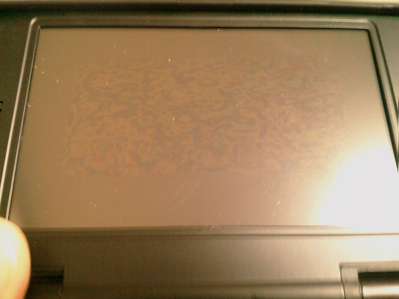

But I find some hardware error in my Pandora.
1. "SELECT" key do not work.
2. LCD shows a strange pattern on it (air bubble?)

As for 1 and 2, that's not normal. The battery case is knows to be difficult to open though.
Is there a bubble in the screen protector? Have you pulled that plastic film off?

That LCD damage kind of looks like what happened to a LCD panel for a mini car computer I made a few years ago.. It happened when I accidentally left it in the car and the temperature went down to -20 degrees Fahrenheit over a weekend.. perhaps during delivery it was left some place very cold.
