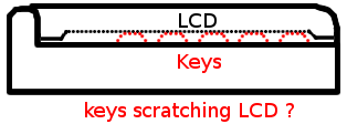

This is an issue I had with all my three laptops. The keys were a little too thick (perhaps a mere 0.2 mm ?) and were leaving traces on the LCD screen. It looks like a "ghost" of the keyboard imprinted on the LCD. It happens only with 5 or 6 keys close the center and not at the borders.
I'm not sitting on my laptops ;) it was due to normal carrying in the backpack.

Normal Notebook keys are concave, Pandora's keys are covex, so they have no sharp edges. The lid is much too small to allow significant bending. The curved edges on the new design help making the lid even more stable.

If the keys are soft and convex, though, it should be easy to wipe off any marks they leave, as it's just residue, not scratches.
try putting some rubber pads (you know like the ones at the bottom of a laptop) where the top two screws in the screen half of pandora - that would result in the rubber pads on screen preventing contact with keyboards.

The keys don't touch the screen. Even with the coated keymat, the keys don't stick up higher than the D-pad and buttons. See that lip around the display panel? That is to ensure the display sits above the D-pad, buttons, and keys.

You can also see on those renders, that the screen is even more recessed. You can assume that the keys won't touch the speaker area when the lid is closed and the screen is further away from the keys than the speaker area.

I have no keys but frame around touchpad imprinted to the LCD. It's due to bending plastics when carrying in backpack.
Pandora due to smaller size doesn't bend as big notebook. And even if then screen protector helps.

Again, this is not an issue for the Pandora. Laptop displays are much larger, so a 1 to 2 degree flex of the panel might translate to several mm of travel across a 15" panel. The Pandora's display is tiny by comparison, so it is both less likely to flex and any flexing that does occur translates to much less distance traveled by the center of the display. You would have to press very hard indeed on the lid to contact the keys. Hard enough that you are likely to break the panel before contact occurs.

A normal backpack let's the laptop shuffle around too much and twists it ever so slightly. You can get special backpack for laptops, however, which support a laptop in a much better way and leave you plenty of room for books, mouse, blanks disks, external drives, etc.
Definitely a non-issue for the Pandora.
