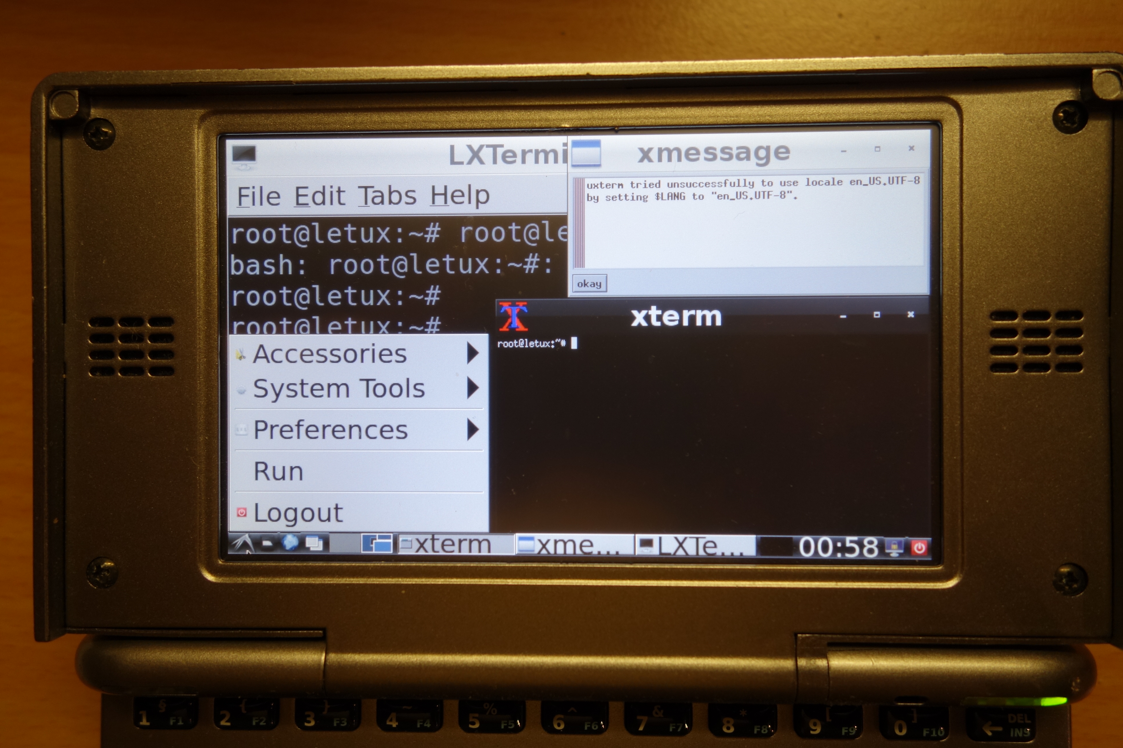

I tested with my CC pandora first the LXDE image and the behaviour is the same as @sle85276 said before.
Next i want to try XFCE and changed this line on makesd script:
openpandora lxde -b OpenPandora/latest
with
openpandora xfce -b OpenPandora/latest
and the script have created succefully the XFCE image for pandora.
So here is the latest letux with XFCE on Pandora:
seem good :cool::p&|a: menu are navigable with dpad, touch and nubs are working (i have my left nub partly working so no use for me), text is big, most of the windows are big (but you could scroll pressing the Start/Alt key and move with the stylus or the mouse or the nubs).
keys are working like with the LXDE (so we are missing some of Fn-x keys).
Battery seems to charge (but like on lxde the last red led on the left is costantly blinking, i don't know if battery related)
No audio device is detected.
inserting a mouse (via USB adapter) work good (not tested with an external keyboard)
so i opened a terminal and typed dmesg:
