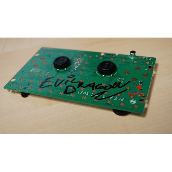

Thanks! I just found it. The sensor is on the right, in front of the fire buttons and gets triggered by the speaker.
I've put a magnet on that spot and the display turned off.
The right speaker is the magnet, the sensor is in the lower case at the same relative point.

I just marked it on the picture:
