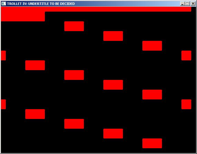

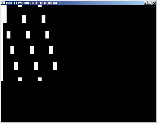

Sorry for the double, but I need your help with making a tile-based platformer..
I want to start simple, so no level editor for now, levels will be hardcoded by using arrays in the sourcecode.
Take a look at my _very_ simple code here. :p
CODE
PROGRAM TROLLET_IV;
GLOBAL
int i, j, map;
int TILE_SIZE = 16;
int level1[20][15] = 1, 1, 1, 1, 1, 1, 1, 1, 1, 1, 1, 1, 1, 1, 1, 1, 1, 1, 1, 1,
1, 0, 0, 0, 0, 0, 0, 0, 0, 0, 0, 0, 0, 0, 0, 0, 0, 0, 0, 1,
1, 1, 1, 1, 1, 1, 1, 1, 1, 1, 1, 1, 1, 1, 1, 1, 1, 1, 1, 1;
BEGIN;
set_title("TROLLET IV: UNDERTITLE TO BE DECIDED");
set_mode(320,240,8,256);
map = new_map(16,16,8);
map_clear(0, map, rgb(255,0,0));
for(i=0; i<20; i++)
for(j=0; j<15; j++)
if(level1[j] == 1) put(0,map, i*TILE_SIZE, j*TILE_SIZE); end;
end;
end;
loop
if(key(_esc)) exit("",0); end;
frame;
end;
END;
Who can help me spot the error in my way of thinking? Because it does not look as I expected it to look. ^^
Thanks, and please answer, it would mean a lot.

It looks like the X and Y are being read the wrong way around.
Try reversing your X (I) and Y (J)placement of the tiles so that it's
For J=
For I=
Order of the X & Y tiledrawing function is important.
[EDIT] YEP, that's exactly it. I've just used your data in BlitzMax and got EXACTLY the same map as you. Switching the X and Y creates the map as you'd expect.

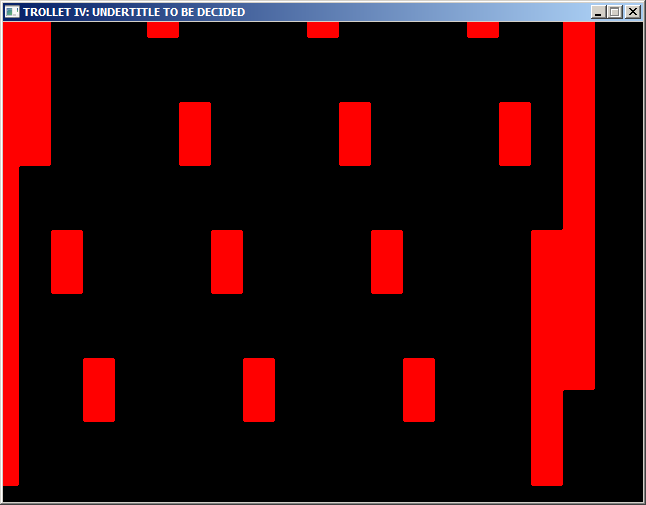

Good thing we got the same problem at first, but something is still not right for me even after reversing the order..
I changed the for to this: (also named the variables x & y so it's easier to follow)
CODE
for(y=0; y<15; y++)
for(x=0; x<20; x++)
if(level1[y][x] == 1) put(0,map, x*TILE_SIZE, y*TILE_SIZE); end;
end;
end;
But it now looks like this:
I even found this valuable information (look at the very bottom code snippet, it's for C/C++ [SDL], but should be exactly the same for Fenix)
http://www.parallelrealities.co.uk/tutoria.../tutorial11.php
It looks to me like I'm doing the same thing, so it's a bit of a mystery for me at the moment.
I've even tried changing the x and y's at different places out of desperation, it creates different patterns..
Everything but the right one. :p
Could you share a bit more detail please?
Thanks again.

I didn't get the same problem first at all - I knew what the problem was and wanted to replicate your example to prove my theory was correct. It was.
I know exactly what is happening here - you are trying to draw the screen taller than it is wide because you've reversed ALL X and Y variables.
The level map should still use "level1[x][y]"
Here is my Blitzmax code, which doesn't differ dramatically to yours, but does what it's supposed to do.

Okay, I looked at your code, but apart from the Blitz-specific code and that you used another for loop to read the data into the array I couldn't spot many differences.
Here's my current code:
CODE
PROGRAM TROLLET_IV;
CONST
SCREEN_X = 320;
SCREEN_Y = 240;
SCREEN_BPP = 8;
TILE_SIZE = 16;
GLOBAL
map;
BEGIN;
set_title( "TROLLET IV: UNDERTITLE TO BE DECIDED" );
set_mode( SCREEN_X, SCREEN_Y, SCREEN_BPP );
map = new_map( TILE_SIZE, TILE_SIZE, SCREEN_BPP );
map_clear( 0, map, rgb( 255, 255, 255 ));
for( y=0; y<15; y++ )
for( x=0; x<20; x++ )
if( level1[x][y] == 1 ) put(0, map, x * TILE_SIZE, y * TILE_SIZE ); end;
end;
end;
loop
if( key( _esc )) exit( "", 0 ); end;
frame;
end;
END;
And now if I run it it looks exactly the same as in my first post again, or your replication of my problem.

Burbruee
Sep 28, 2006
302
Skåne, Sweden.
Visit site
iprice said:
OK retry reversing the X and Y in the Level1 array, but instead of using x<20 use 15 and vice versa with Y.
CODE
for( y=0; y<20; y++ )
for( x=0; x<15; x++ )
See how that displays.
Tried that, it looks like this:
