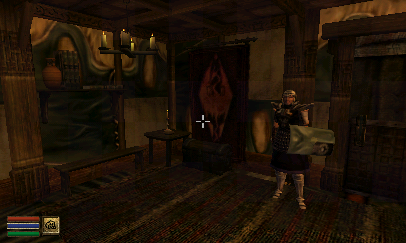

So, the crash is openmw is due to the Sun...
Sun glare are handled with glQuery, wich is not supported on glshim.
I'll try to hack-disabled that in openmw. If it turns out to be too complicated, I'll try to hack some dummy Query in glshim.
Found a way to activate some NEON code wrote by Apple in Bullet3. That give some boost, but not enough to be really playable.
Fixed the issue with the sun (well deactivate the glQuery calls), so you watch the sky without crash now.
I still have an issue with the starting, the windows is always minimized and the 1st animated logo isn't shown, and it seems to segfault at exit (probably trying to free the same tls variable that made it crash before).
So still not ready for package...
