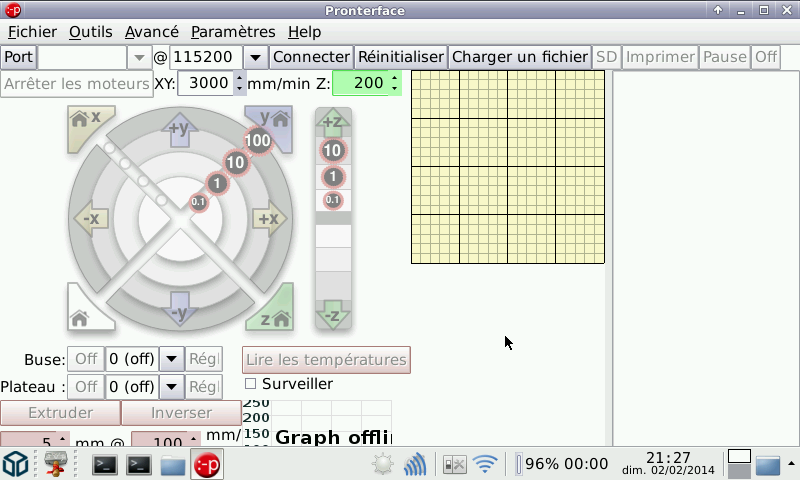

But, because I have no 3D Printer, I cannot test at all.
And I think it will be tricky to package... I'll try put a beta PND in here so the lucky owners of 3D Printers can test and report...
I have yet to try Pronterace itself, I didn't really think I'd have to much trouble with it.. However what I was have issues with was Slic3r, which is a program that converts the STL model to G-Code which the printer understands.. What I was having trouble with was getting all the features of Slic3r working right. After compiling it runs some tests to see if the features of slic3r work properly and some of the tests are failing, I think it may be some math conversion issues, pehaps the difference between ARM and x86.. Skeinforge is another program that does similar task, but most people migrated to Slic3r.. Pronterface uses either Slic3r or Skeinforge to handle the model to G-code conversion.
Was Slic3r or Skeinforge built with this package? and did build correctly?

So, I have a beta package ready.
Because wxPython and all Python lib is huge, I have created a Standalone wxPython PND, including a command line to use Python, NumPY, wxPython, etc... and I'll publish later a "how to" use the PND in your PND.
And then I have the Printrun PND. It use wxPython PND (it autofind and automount it). I have included skeinforge (because it's easy to include, just a bunch of python files), but I cannot test so I cannot say if it works!
I will publish wxPython on the repo (because it's a 200Mo+ PND!), and first beta of Printrun here (just the time for last couple of test and then try to upload it).
