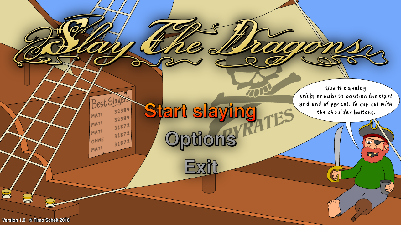

As an englisher, your texts read fine to me. The only question I have it about 'the analog sticks or nubs'; the pyra has nubs and a stylus. Are you referring to the nubs as being joysticks on other systems, or can you also use the stylus for one of the end points?
Thanks for the feedback.
No, you can't use the stylus in this game.
I just didn't know how to call the "analog nubs".
You can play the game with a gamepad (either connected to the Pyra or a PC). If I just call them "analog nubs", I think many people wouldn't know what I'm talking about, because everybody calls those little sticks on the gamepad "analog sticks".
If I just call them "analog sticks" it would be strange, because the Pyra is the main plattform I'm aiming for. And the Pyra doesn't have "sticks". It has "nubs".
So I ended up using both terms. Maybe I was overthinking and made it unnecessarily confusing.
