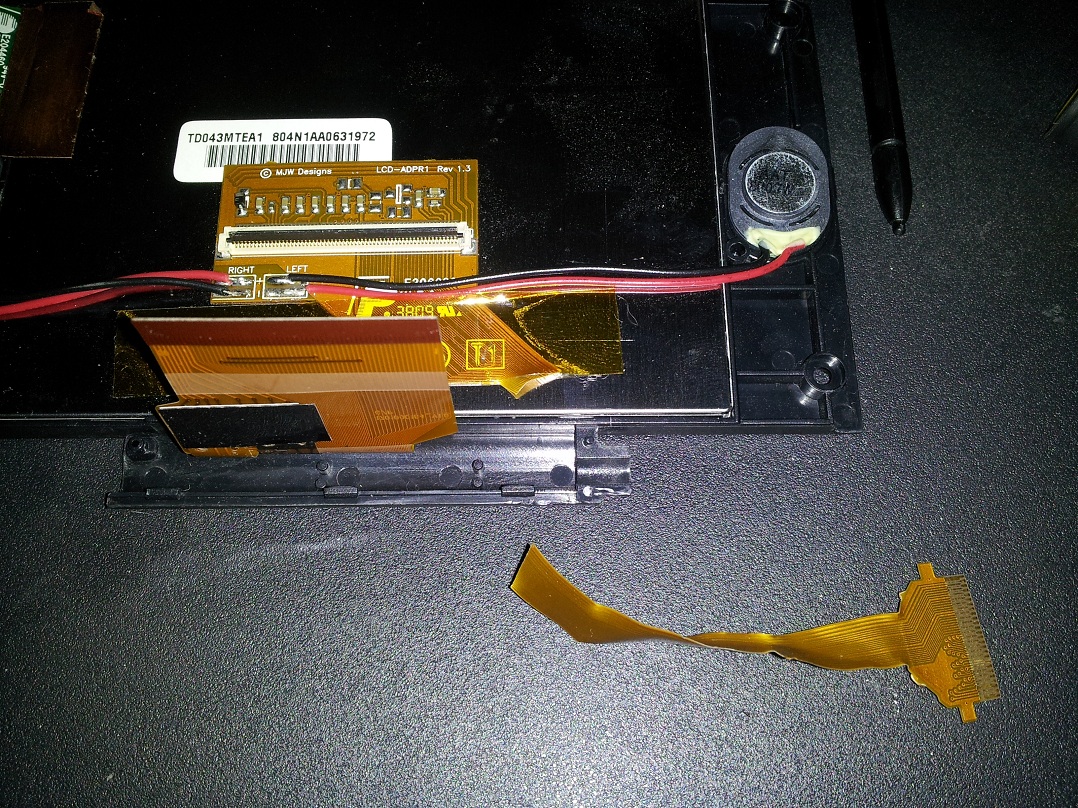

Hello,
I'm starting to see the symptoms of the screen cable wearing out (pink lines.) It only does it if I move the lid while it is on.

Replying to my own question, haha.
See attached picture. Going in to reseat it, I managed to snap the cable completely in half. (EvilDragon was NOT kidding when he said be careful!)
So... I need a new LCD cable. How do I order one?
Thanks.
Replacing the cable is exceptionally complex if you have never done it before, I've been genuinely amazed that some forum members have managed to do it on a first try.
I'll need to see when we're getting more cables, I don't think we currently have any left here, Ed might have some.
Amazed? really, if you're careful, it's a pretty easy but skillful task. I've done it twice without damaging anything!

The memory question was just a question. Right now, I need an LCD cable. Is it possible to purchase one?
My soldering rig arrived today. I can fix stuff within the US and have a few extra LCD cables I brought back from Germany in March.
Are you willing to part with one? Of course, I'll pay for it. :p I like having a spare part or two.
I can mail you one if you are in the US. I didn't pay for them, and shipping one doesn't cost much. Are you comfortable putting it back together?
I'm comfortable putting it back in. The reason it snapped in the first place is because the lid hinge is very tight and I applied too much Berserker strength without thinking "I should probably snake the LCD cable through the hole first," like an idiot.
I honestly don't mind paying for it... but if you're offering to just *give* it to me, I won't look a gift horse in the mouth! :)
However, if that's the case I would like to toss you something for shipping and helping me out regardless.
