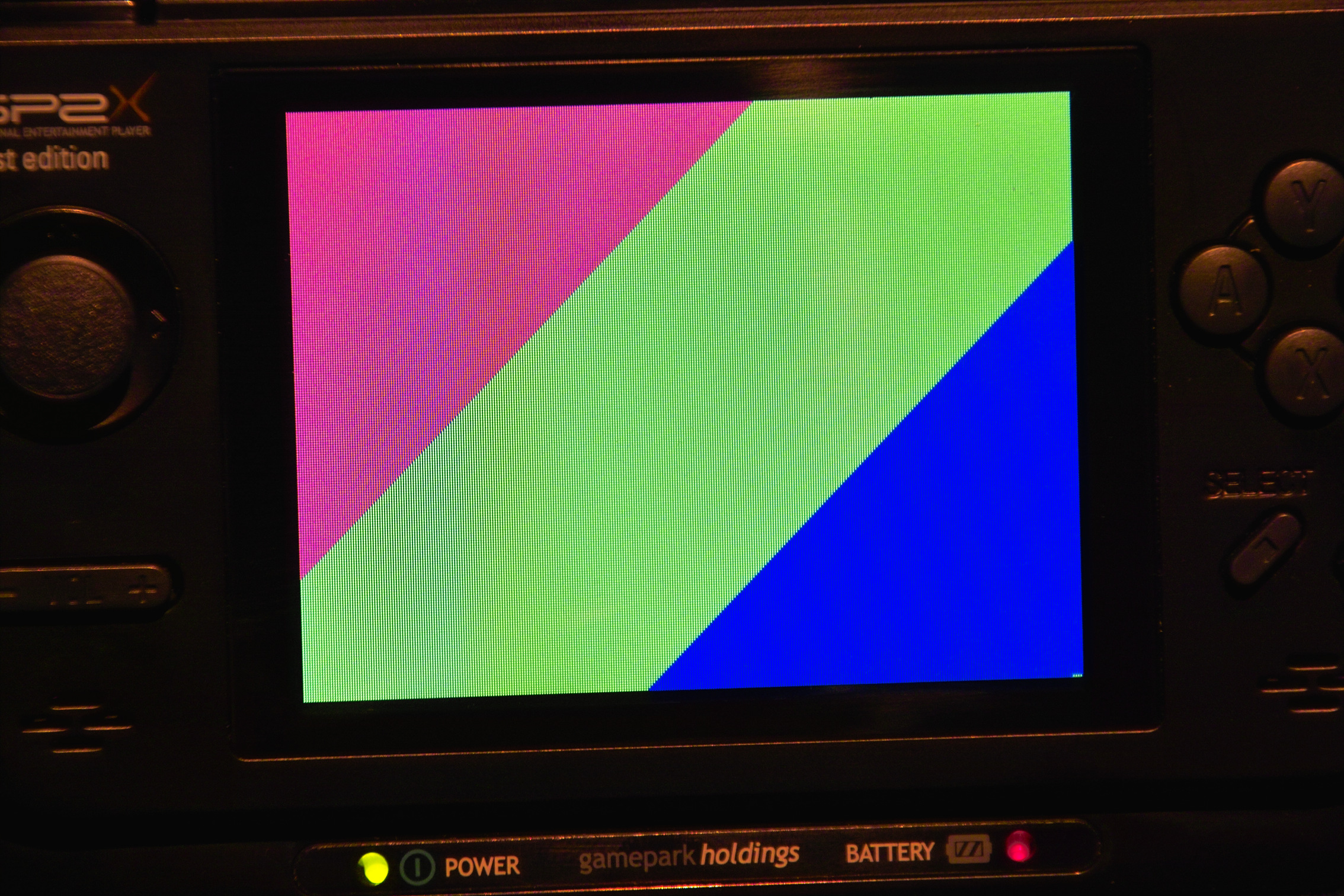

Okay, just got a HH-Test (which kicks out the GPH Linux and displays some pictures) program.
The HH-Test only shows some colored bars, no black and white.
But: If you look at pictures with the GPH firmware, you can see some disturbance and even slight contrast problems (even in color-only-pictures).
The HH-Test did show an absolutely clear image, without a single disturbance (and without the vertical line).
So I think the LCD is fine, it's just the firmware (again... sigh. Good thing we have that good devs in the scene :))
In the screenshot I noticed some imperfections: bottom right a line of maybe four wrong colour pixels.
Also, does HH eliminate the problem with one half of the screen being slightly brighter than the other?
I think that's part of the test ;)
They are meant to be there.
Never even had that with my gp2x, I think that's what the first FW updated fixed.
But it's definately not there on HH.

Thanks E.D. for the information and the nice image.
Very reassuring to know that the Hardware Hack shows that there aren't any major worries over the screen. :)

Sure, it's not a working firmware, it's just an LCD test which bypasses the GPH Linux and runs directly on the hardware.
Don't know if you can notice the difference on a photo, though...
Hi-Res Picture
That test won't show the problem though. All colors are about the same intensity and cover the screen evenly.
To really test it right you will need to display an image like the first one, a white square against a black backdrop.
To me it looks like a cheapo LCD or LCD driver chip where the voltages are not right. I have seen this on other older displays, like real old laptops with passive matrix displays. That wasn't a software problem either, just a shit quality screen.
Hi-Res Picture
To me it looks like a cheapo LCD or LCD driver chip where the voltages are not right. I have seen this on other older displays, like real old laptops with passive matrix displays. That wasn't a software problem either.
My unit has the same horizontal lines and I was just thinking exactly the same thing.
