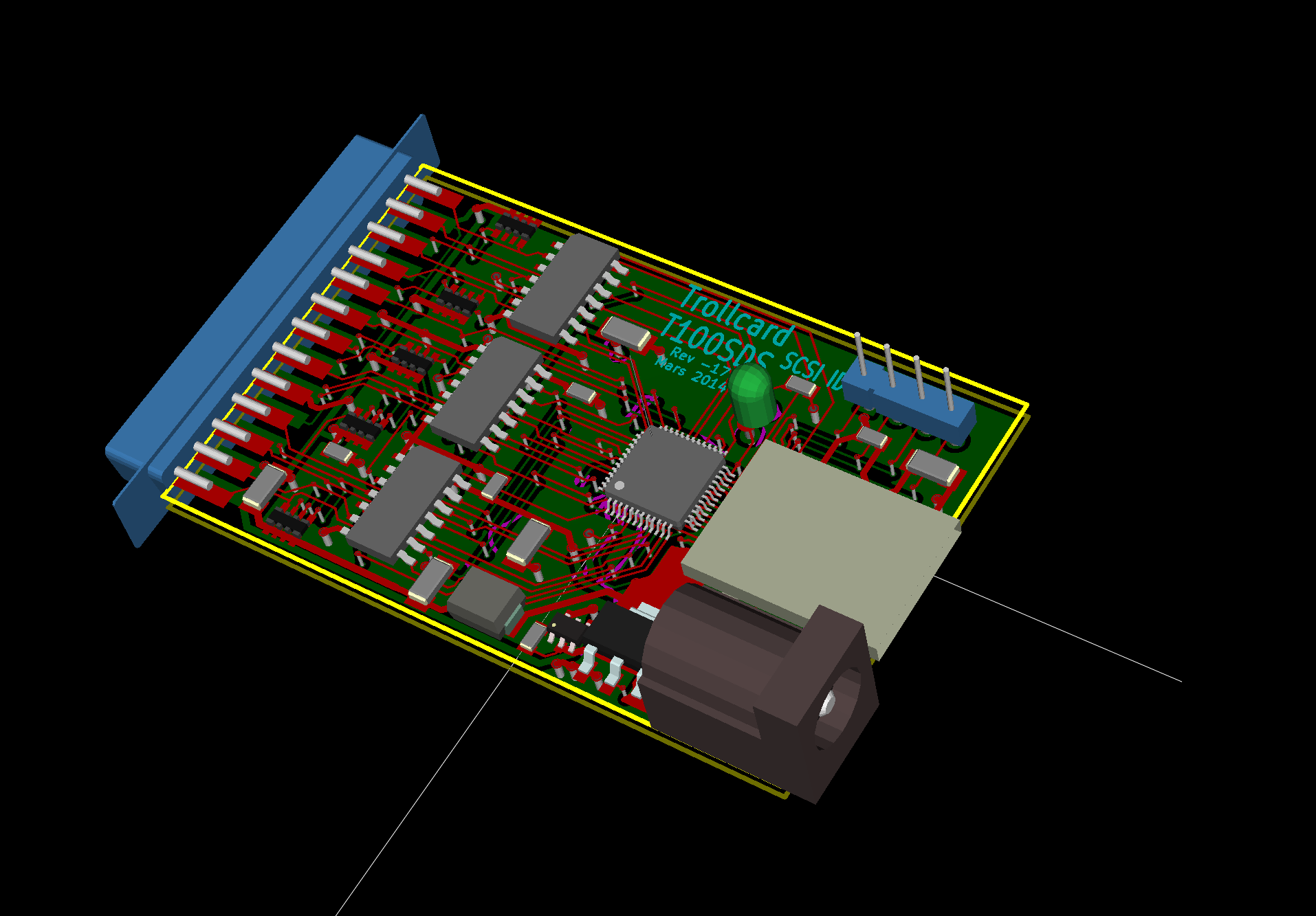

So, for the past few weeks, I've been working with a friend on a SCSI SD card reader. This is intended to be a lower cost alternative to existing SCSI card readers, that are getting more and more rare. It will plug right into the DB25 socket, with the device having a male plug, removing the need for a SCSI cable. It will also have built in terminator. Storage will be an µSD/µSDHC.
Provided there's enough interest, the plan is to make this into an actual product. Can't be too specific about expected price as I have yet to speak with any distributors (although ED seemed interested in carrying it when I mentioned Amiga 3000 has a SCSI port...) However, price is a key goal, and I'd consider a retail price over €50 to be a failure. The manufacturing costs won't be anywhere near that though. Speaking of which, that's another thing not yet fully determined. We do have a preliminary BOM, but ofc, it's still early in development..
Current status: We just got a first prototype running. It's still a mess of wires on protoboard, but when this works, and shown interest is high enough, dev boards will be made. These will be used for CE EMC testing, and will be sent out to distributors for trial, apart from being used for polishing up the firmware. These will be as close as possible to production hardware.
It will come in a case.
As for the current protoype, it is currently capable of booting Mac OS8. It's not very fast yet (all code is a straight C implementation on a Cortex M0 µC...) Within the next few days, the read/write code will be rewritten as a tight assembler loop.
Theoretical max read/write speed is 3 MB/s. Aim is at somewhere between 2-3 MB. Currently, OS8 needs special software (requires Lido 7.56) to format the SD card.
Prototype pictures:
Testing will later be done on an Ensoniq ASR-10, and hopefully some amigas.
