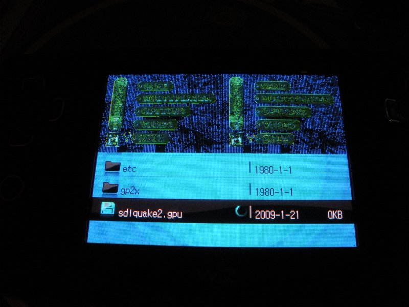

It start, but the framebuffer is completely trashed.
pepone said:
Pickle said:
Ok ive uploaded the dynamic version if someone has a working SDL: Here
You should be able to create a baseq2 folder next the binary with the pak files and it should work...
Great now we are getting somewhere...i think this do to screen being set to 8 bpp. Orkie ran prboom and had the same problem. So it must be something with the SDL.
Yeah, it is to do with 8bit colour, though I was sure Puck managed to fix this months ago :S.

Second thing is the screen, mine has a nice tear sometimes going at a diagonal from bottom left to upper right. I dont if this related to the white dia line mentioned in the other post. But it seems all we had to do was rotate to work around the white diag (which I havnt seen). Anyone know anything about this?
