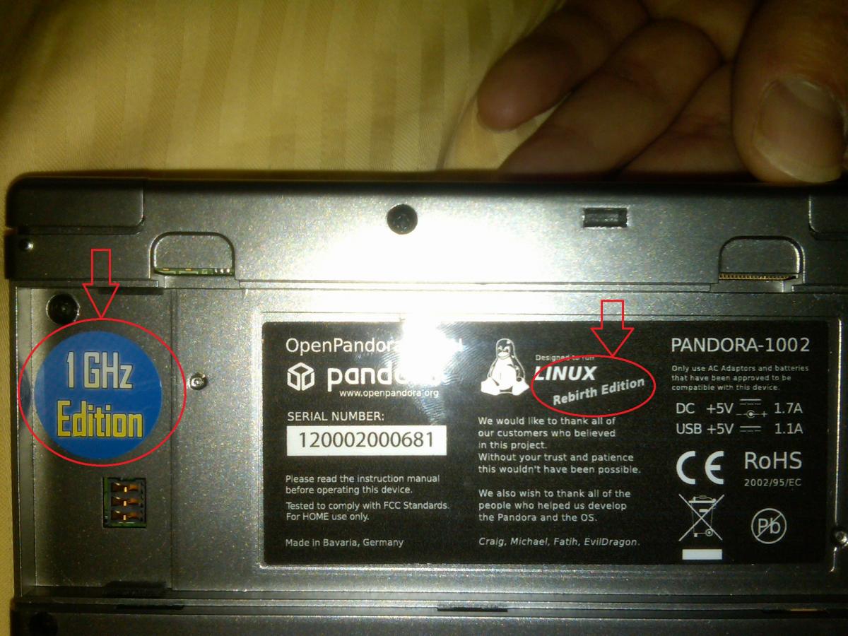

May be this is a dumb question, but I've owned my Pandora for a couple of months now and I noticed that in the bottom of the Pandora there's a sticker saying "1GHz Edition".  However, there's also another marking stating "Rebirth Edition".  I know the 1GHz Edition is more expensive and better so I ordered and paid full price for the 1GHz Edition.  Now that I saw these two markings and they make me wonder which version of the system I have.  Could you help clarify this?
Here's the image I took:
The GHz Pandoras are actually part of the rebirthrun. Don't worry ;)

The Rebirth Pandoras get only the black lable which says "Rebirth Edition".
The Giga Pandora get the blue 1GHz sticker.
If you upgrade your unit you'll keep your "First batch" or "Rebirth edition" sticker and get a 1GHz sticker.

There is. It is called "The little blue sticker" :D
Well try this, go to a terminal and type:
cat /proc/pandora/sys_mhz_max
if it reports back as 400 then it's a 1Ghz Model, if 332 it's a rebirth or classic unit.
This is the clock speed for the pll that controls the Memory and SGX speed.. from Notaz post on it..

Yes I tested and 400 came back.  Yeah!  I'm happy now! :D    Thank you all very much for helping!!! This the best support I've ever seen!  Better than Dell and freaking Microsoft  :D
