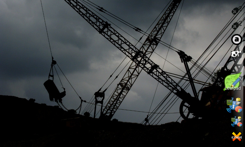

How would I move warlockbar to be vertical?
I tried changing pos = bottom to pos=left, but that doesn't change its orientation.
Also, Could the 'shutdown' option be changed to open a window for either shutdown, logout, lock or cancel?
You also need the -vbar option. All the options are listed here: http://dev.man-online.org/man1/wbar/ - you may need to play with the other ones to make it look good (it looked a bit rubbish when I tried it).
