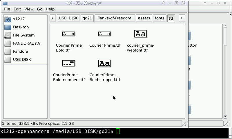

Hmm ... I don't understand what could be causing this ... all my changes were just so the GLES2 part works with egl under x11 ... and setting a different default videomode ...
One thing that might be a little suspicious though is that it links against libfreetype.so even though the sources of freetype should already be in the engine ... but trying to build without freetype seems not to work.
I'll see if I can find out more, but I probably won't have much time for the rest of the week :(

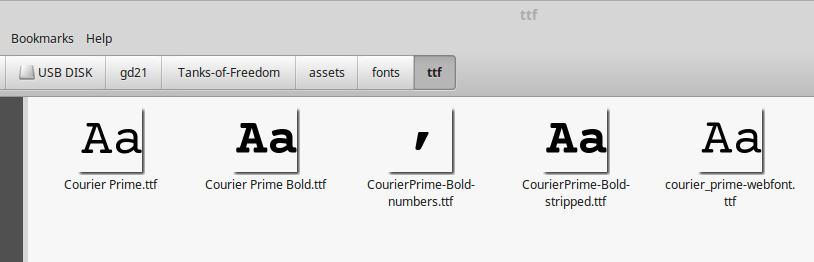

I had a look at the fonts and there seems to be some kind of problem outside of godot ...
here what they look like in the file browser on my PC:
screenshot-from-2016-08-23-20-51-06-png.29075
here the same on the Pandora:
screen160708-153152-png.29074
Too much spacing inside the font itself would explain this. Some of them are looking ok though - maybe we could try replacing bad ones with these (or any other ttf) and see if it helps?
Edit:
and revert the theme change, as it should not be required.
@x1212 @czlowiekimadlo Solved!! The problem was that i didn't included any lib on PND because i thought it was a static binary...
Now it uses libfreetype from Codeblocks PND, more up to date than the one that comes with OpenPandora OS.
