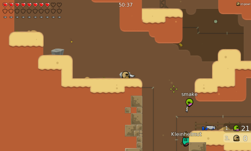

I tried to port Teeworlds, v0.6.1, on the Pandora.
The game is a "retro multiplayer shooter".
It use OpenGL, and is available on many system.
I converted the OpenGL -> OpenGL-ES code (using the excellent wiki here http://pandorawiki.o...to_GLES_from_GL).
It works well, but, the sound doesn't. If I try to activate Sound, the soft Segfault at start, some memory corruption somewhere...
It is on the repo here: http://repo.openpandora.org/?page=detail&app=teeworlds_ptitseb
Here, find a screenshot of the game (taken from the Pandora): previews1.png.
The game is pretty, fluidity is good (at least at 1Ghz, didn't test at lower speed), but I didn't find a good control combinaison to make it fun to play. The nubs are too slow (for my taste), and the touchscreen is not really usable (as the game capture & move the mouse, there is a offset and the cursor is not where you tap).
