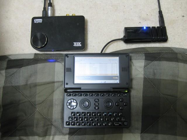

I thought I should share the following since it turns the Pandora into the ultimate audio player:
You need:
- Pandora
- Audacious installed
- Hub for USB 1.x compatibilty

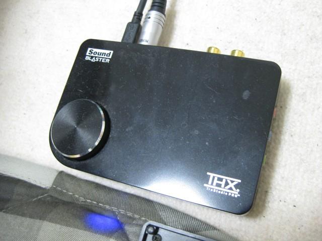

- Soundblaster USB to Optical exit
- A decent amplifier at home with optical in, and decent pair of speakers.
Here is the soundblaster USB to optical device:

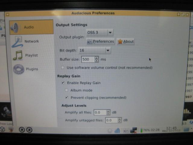

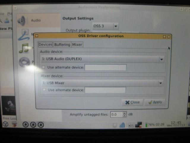

Set the following in Audacious: OSS3 for output
Then go in preferences and set USB for both menus in there.
Now enjoy pure, lossless sound from your Pandora on large and powerful speakers. Must have!
