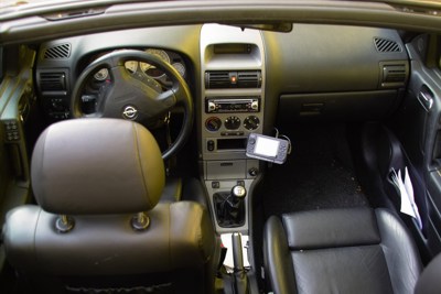

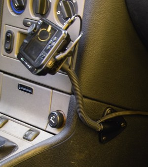

Since my iPod has a broken display since a while and the Cradle of my IceLink (that's an adaptor to connect the iPod to a Sony CD/MD-Changer Car Radio) is also broken, I thought it's time to build something new to be able to listen to some music again :)
Sooo I built the following:
Cute, isn't it?
Works the following way:

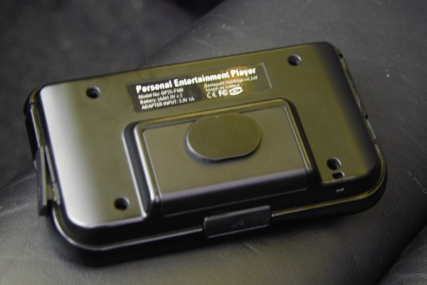

First, a small piece of metal on the battery cover of the gp2x:

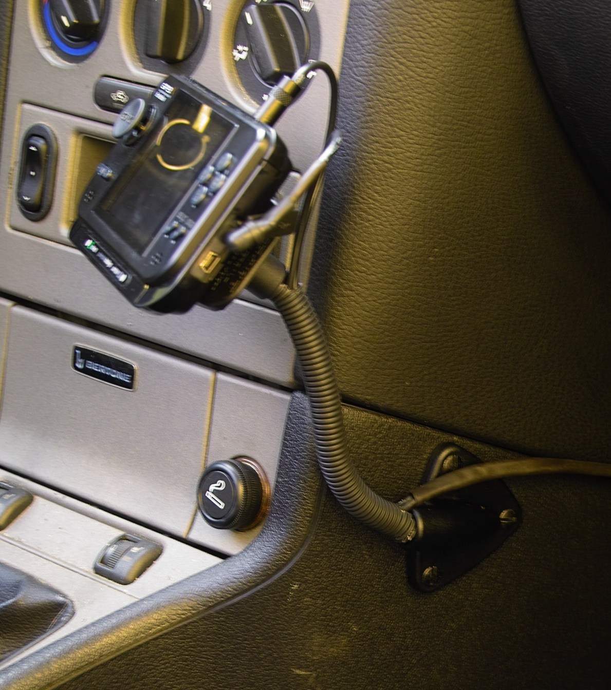

Because that metal is part of that universal mobile phone car mount kit:
(Here is that pic in big)

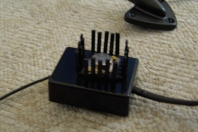

One problem I had:
The gp2x needs stabilized 3 Volts.
A car battery voltage output ranges from 8 Volt (ignition) up until 14 Volts (when the battery is charging).

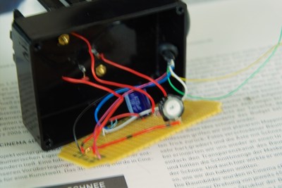

So I built a small circuit:
Nothing big, parts did cost 5 - 6 Euro. It stabilizes the current to exactly 3 Volts, works up until 1,5A (which is more than enough for the gp2x)
It works pretty well - in fact, it works THAT well, that I can start my car while the gp2x is running - and the gp2x doesn't crash nor even flicker.

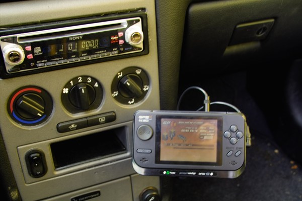

Sound output for goes back into the IceLink, since I don't have a car radio with AUX Input (and the IceLink simulates a CD / MD - Changer)
Since IceLink also offers a serial protocol using the Apple Accessory Protocol, I could use my car radio to change the tracks on the gp2x if anybody codes that protocol into the gp2x ;)
That's it :)
Here's another, last picture:
(Also available in big here
Heh, now I've got a car radio that can play movies, MP3s, SIDs, SPCs, MODs, etc :)

Now that is the work of a true PIMP. I love it. Nice clean mounting job. Do you have it hooked up to an FM transmitter? I can't imagine listening to the 2X speakers in a car.
Nope, much better :)
It's connected to the MD / CD Changer Audio Input, best quality possible :)
Sounds absolutely brilliant via the car speakers :)
