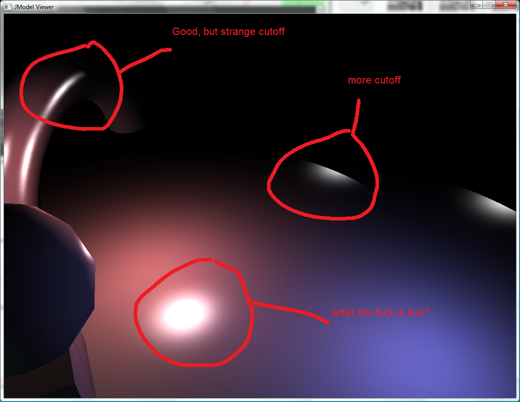

darkblu, I implemented what I understood of that (which wasn't much without comments) and just got a black screen.
I'm playing around with specularity, it works fine on my torus and sphere, but pants on the floor, pluss it has some strange cutoff. (it's not affected by attentuation).

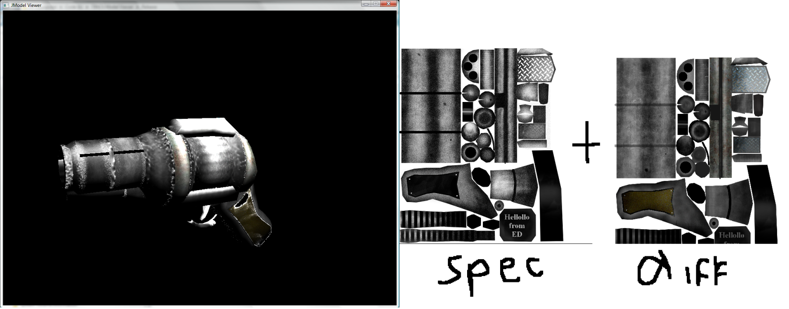

Ok. I've sorted out the above. Now modellers, does this look correct? The right hand side show the two textures applied to the model.
Does that look like it should?
The light is on just above the area where the brightest part is on the top. There's a few more lights about, but i've forgotten where they are xD
No, I doesn't look rght.
But don't worry probably you only have to invert the colours of the spec. map.
For what I can see the model (in some pats) reflects exacly where it should be darker.
The problem is that that doesn't happen everywhere, for example the light on the magazine reflects well...
For now try only to invert the colours... Then we will see....
And thank you for the test :D
P.S: Plus there is a problem with my maps... the diffuse is right but the specular one is too affected by the differences of resolution between a part and the other... But that is my error :)

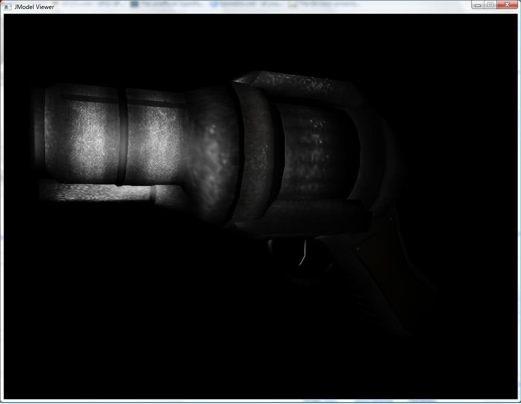

Yep, that looks MUCH better Butterman. Good job with the spec maps - they make things look a lot prettier. :D
Im getting tired of looking at random cubes for the tests.
Ill try and put togetther a test model pack on the weekend.
In it i plan to have a good looking low poly head, a crate and some other random models.
That's perfect! Very very nice...
Just to see how the lighting works you can take a picture with multiple lights because in this photo we can only see a part of the gun and I would like to see the reflactions on the rest..
I'll make it brighter (more white in the texture) but that's trivial... Thank you very much...
