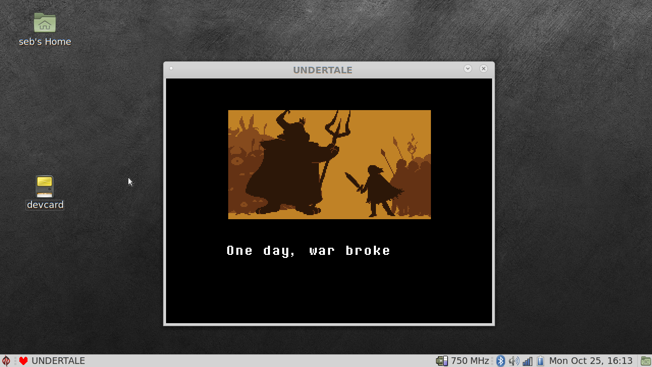

You can now launch install script, and x86 program. When launching game, don't forget the "gl4es" wrapper. So for undertale for example, use
Code:
gl4es ./UNDERTALE
in the UNDERTALE folder.
