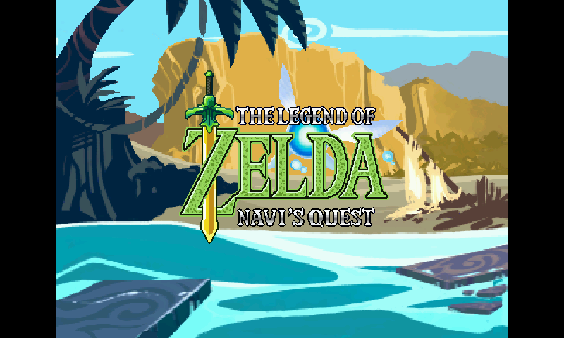

Vincent Jouillat gave us yet an other game to toy with.
My changes :
v1.0.0.3:
- Improved pandora button mapping (again)
- Support for saves on fat (packaging fix)
v1.0.0.2:
- Support for both languages (packaging fix)
v1.0.0.1:
- upscale using neon_scale2x from M-HT.
- add support for pandora keyboard
[ Repo ]

Two suggestions, in case you'd like to improve this port further:
- adding vsync would be nice
- and most importantly, remapping controls to the Pandora buttons would make the game much more enjoyable.
Cheers! :)

So my question, is : what's missing ? what's wrong ?
Hmm sorry sebt3, I had missed that line (au fait je suis français, j'ai juste écrit en anglais pour que tout le monde puisse comprendre ;) )
I don't have my Pandora here, but when I tried the game, I thought that the buttons were not responding. I had to press keyboard keys, like RETURN for example, to trigger actions. But maybe I'll have to retry this. Sorry if I made a false report ;)
Then... just tell me what mapping is missing.To switch to english I just have to add a file. repacking will be fast. I just dont want to re-upload the package for such a tiny modification.
So having the buttons mapping improved would help to justify an update.
I don't mind waiting for an en version, plus I have no time to play this week, so no rush.
Well, I'm just at the beginning of the game, so I don't have any special object or a sword. But as far as I can remember, here is the current Pandora mapping:
START = ENTER (to validate or skip messages, and enter inventory)
SELECT = ESCAPE
??? = SPACE (couldn't find the button associated to space, in order to read signs, except the SPACE key itself)
B button = C
Not sure of the rest...
So my suggestion would be:
START = ENTER (skip and validate)
Y button = SPACE (read signs and open chests)
B button  = C (move objects)
A Button = X (use selected object)
X button = Z (or W, to use sword)
L button = SHIFT (run)
R button = CTRL (to move Navi?)
Again I don't have my Pandora at hand, I just checked the PC version to see the default mapping.
SDLK_PAGEDOWN (x) sword (z)
SDLK_HOME (a) secondary weapon (v)
SDLK_PAGEUP (y) map (p)
SDLK_END ( lift+run (c) & (x)
SDLK_LCTRL (sel) Quit menu (esc)
SDLK_LALT (start) Weapon menu (enter)
as far as my notes goes. (hint R is ctrl by default, I didnt need to change this as it worked well)Indeed i'vent mapped space. On which key should I map this ?
EDIT: tried to add space on ( B ) button with run and lift. Instead of reading signboard link lift them. No luck here
I've tried something for the mapping. Should be nice. Tell me if that multi usage of the ( B ) button is of a problem.
so I've uploaded a new version (also known as the "doh ! just under my eyes" release) which fix the french only behavior of the initial release.
Also thanks Michoko to have made me use my mind :p

No this is fixed, english version is now included. to switch language, just use the options in game (on the select profil screen).
BTW this release is still not the final : cant lift pot with ( B ) with the current version :(
