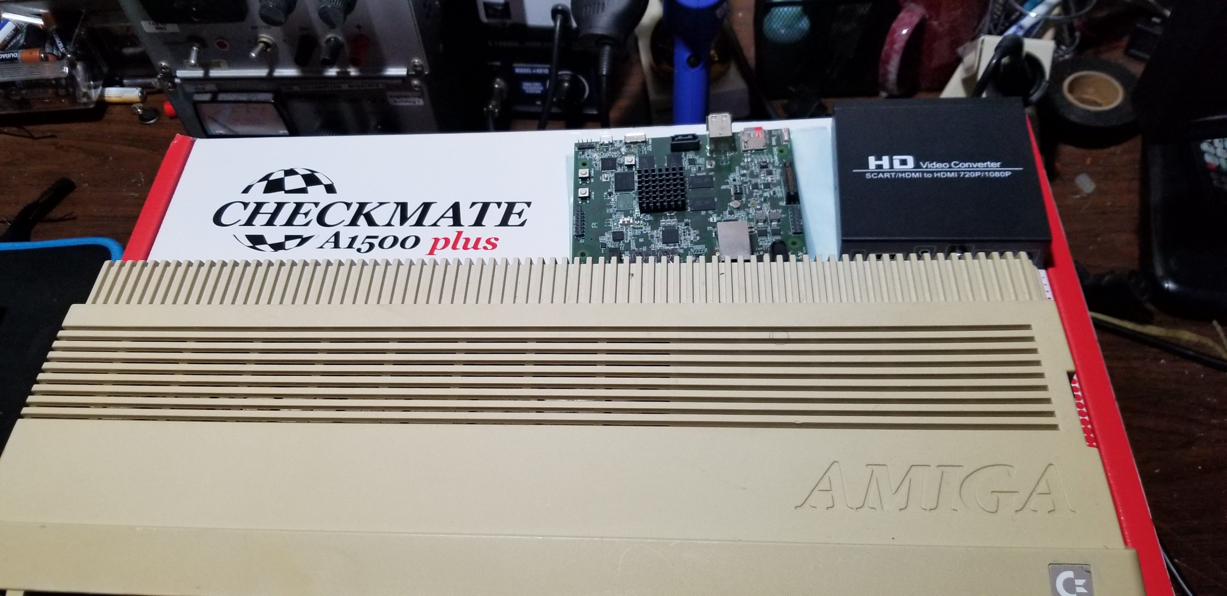

    So my case is in, but haven't touched it yet as I'm still waiting on the SFX power supply to come in.
    I have a few goals with the case project, this will be replacing my A2000 as my primary Vampired Amiga setup, As I'm trying to save space and the Checkmate case is considerable smaller.
    • It will have the V2 Vampired A500 and the OMAP5432 EVM devboard in the case.
    • Removable storage accessible externally.
    • OMAP5 devboard reset and power buttons brought to the front.
    • KVM like feature to allow use of the same keyboard and mouse
    • Vampire HDMI + Amiga RGB through a single output ( Will need to integrate my HDMI + Scart to HDMI converter box )
    • Maintain a real Amiga Floppy drive
    • Have the USB Blaster programmer for the vampire available in the back port to allow programming of the Vampire of development cores that are not in their normal Self executable format.
    So this will be a pretty odd janky project of electronics, 3D printing and such. The video output and switching may be a fairly involved project, for example to keep it clean I may need to tap into the RGB traces on the A500 motherboard, wire it directly to the HDMI + SCART to HDMI scaler/converter... which I'll likely need to hack a part, Luckily I have a spare one.

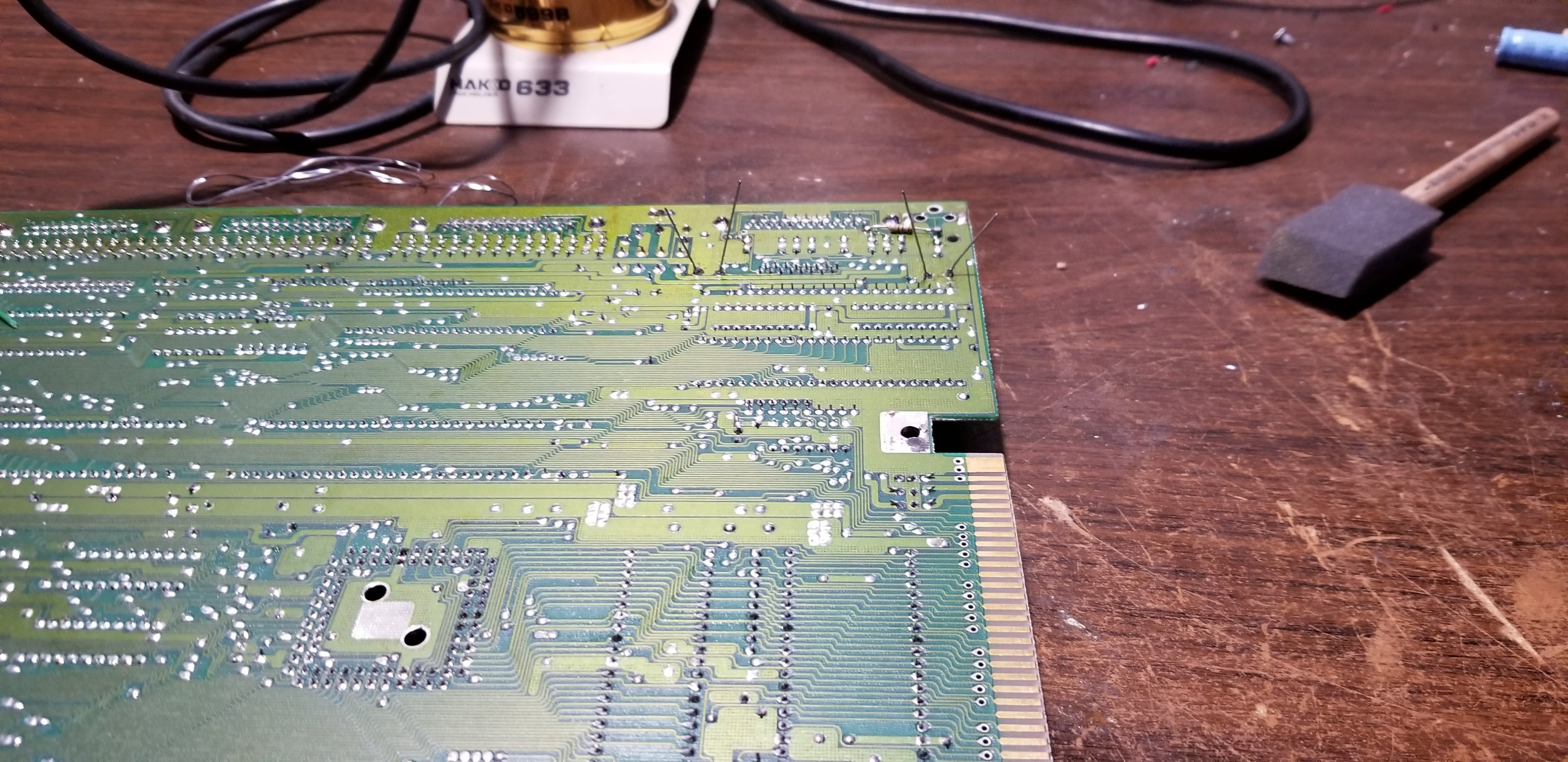

    First step I did yesterday was prep the A500 Motherboard, Replaced the 30+ year old electrolytic capacitors. I installed the chipram expansion and the USB keyboard adapter that hijacks the keyboard signal from the CIA chip, which will allow me to use a regular compact USB keyboard.

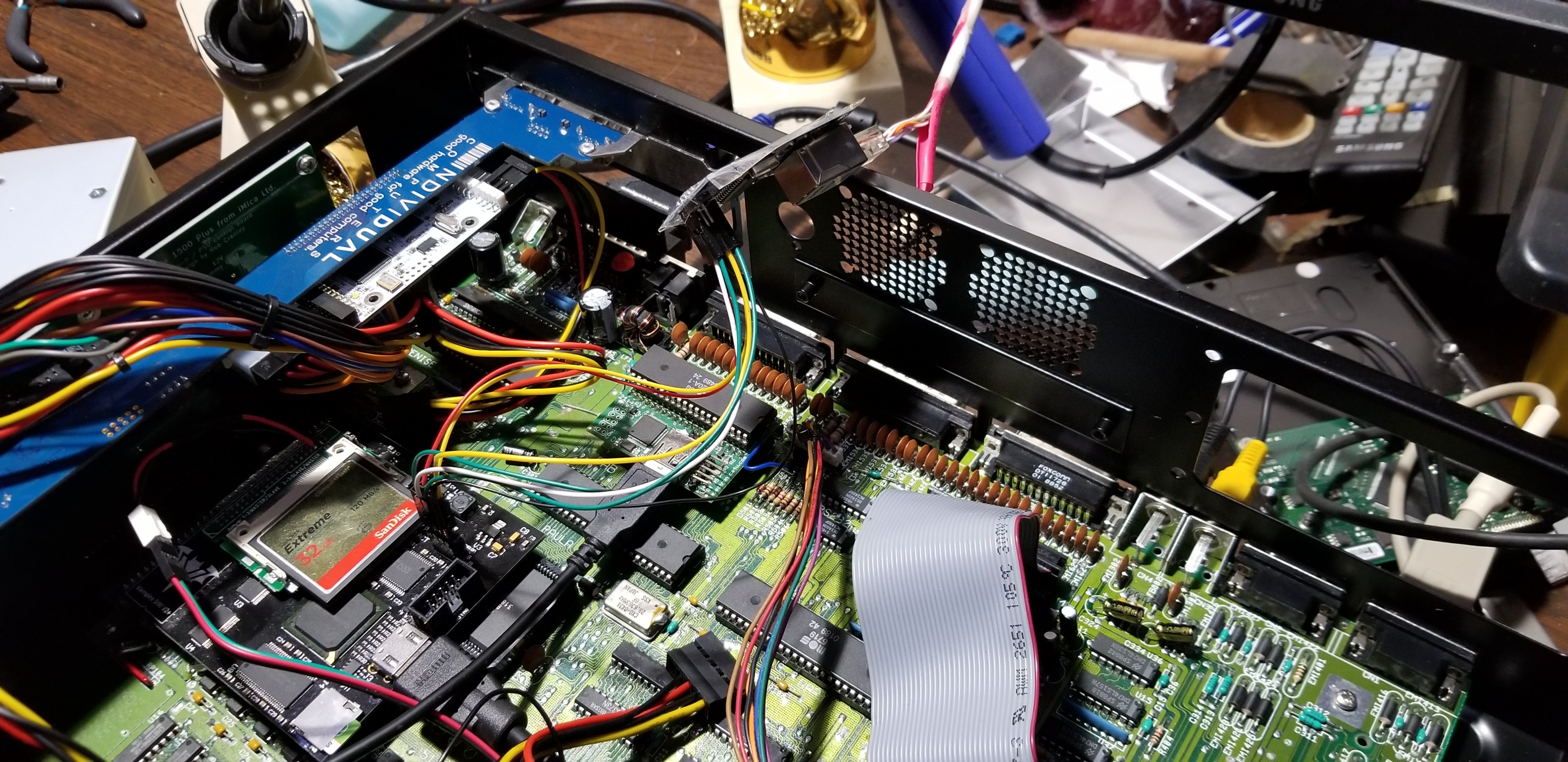

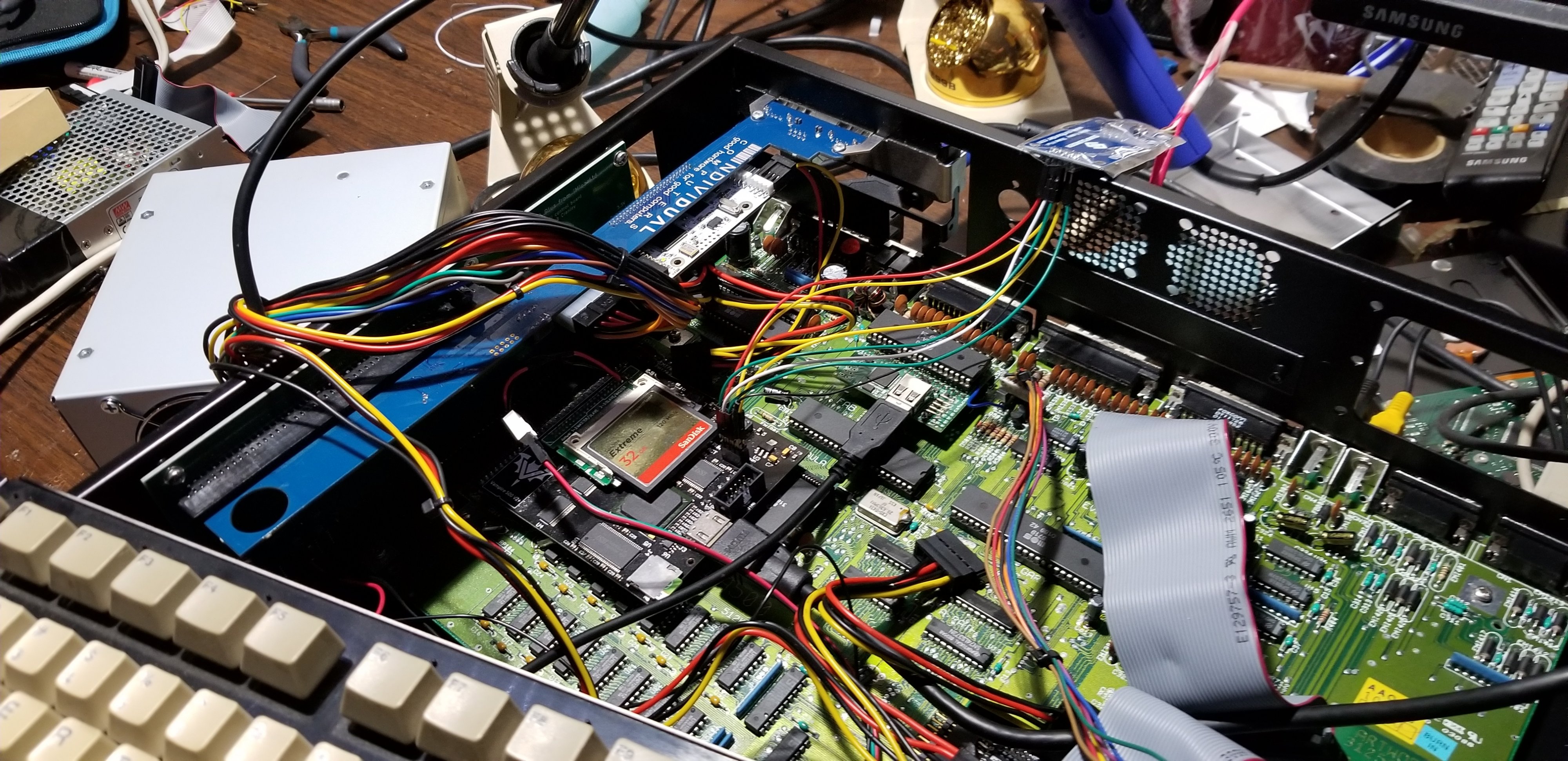

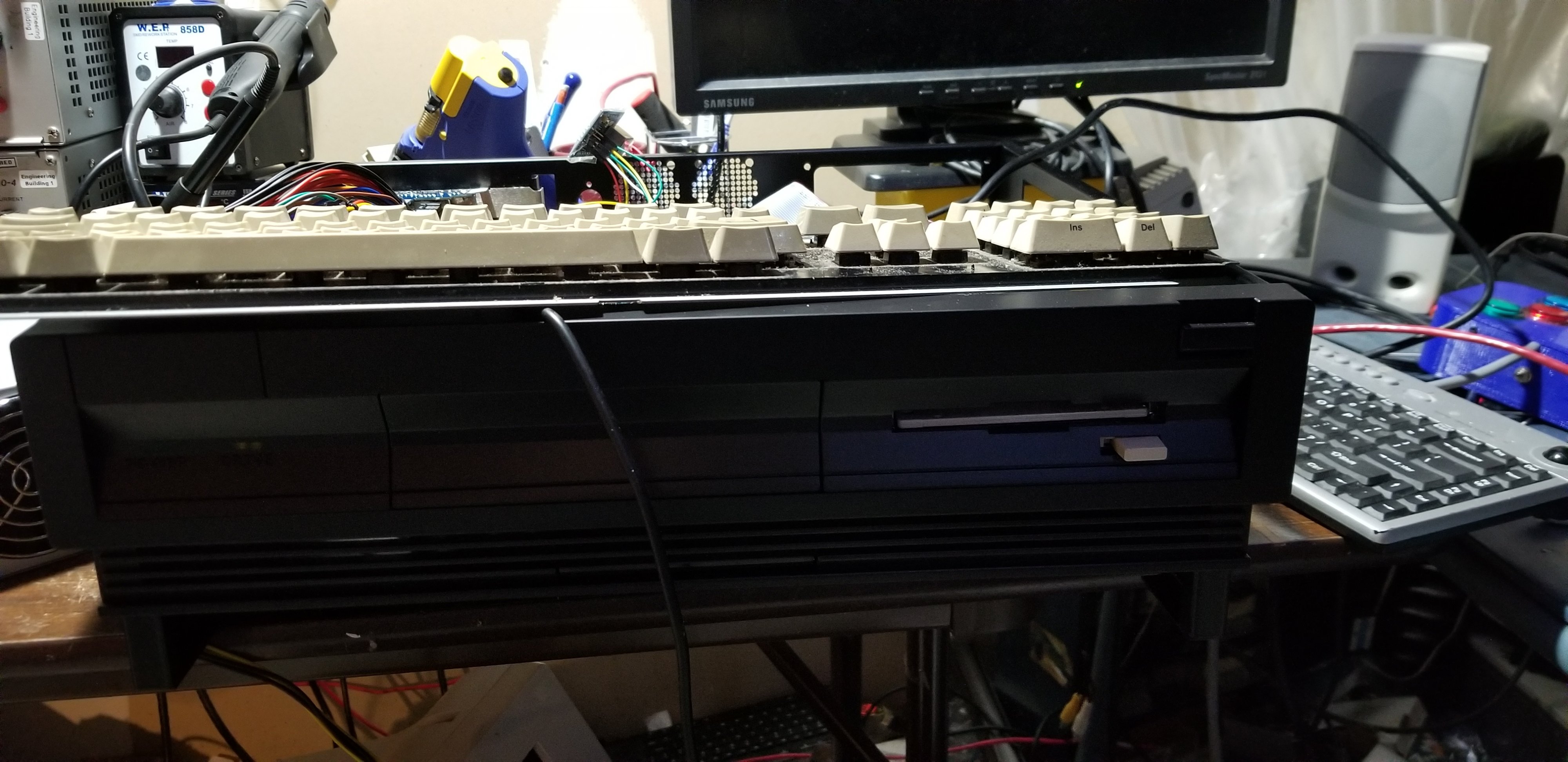

    Part II of my adventure...
    Well the A500 Motherboard slid in nicely, got the vampire V500 V2+ in, Floppy Drive fitted nicely. However just a few snags, The Individual X-Surf-100 Ethernet card doesn't appear to be working with the A500 in the zorro II expansion adapter. Tried known good driver setup from my A2000 and think it must be related to the lack of DMA buffering due to the lack of the Buster chipset found on the A2000, I was told this shouldn't be an issue as I'm running a single card, but perhaps that isn't the case. What is odd the RapidRoad USB controller that fits into the expansion header on that Ethernet card works fine. I've pinged a few forums to see if anyone else is experience this, but not getting much out it so far. I'm not totally in the lurch, there is a solution on the vampire V2 expansion header using an SPI to ethernet module, shown in the picture below.
    The other issue I'm facing deals with the keyboard, the fancy compact mechanical keyboard I picked up and bought special MX cherry Amiga buttons for doesn't seem to be recognized by the little CIA chip USB keyboard adapter. I do have a small keyboard that does, but it's not mechanical. other issue I've noticed It looks like it has a UK or EU English layout and I need to figure out if this thing can change regions, but it lacks any bit of documentation.
    Power supply comes in tomorrow, so I can prob at least close the case until I approach dealing with the OMAP5 devboard side of the project.

    Well the issue is I get a ' instead of the hash, but no combination of key presses give me a hash symbol. changing layouts in the OS seem to reverse the issue, I get a hash symbol, but lose the other. Currently I'm lacking any information on the USB keyboard adapter that hijacks the keyboard input from the CIA chip, it was an Ebay purchase from Poland... I'm digging through google now.
    Outside of wanting it to coexist in the same case not much. I do want to make a Custom KVM switch so I don't need to run two sets of keyboards, mice and monitors.

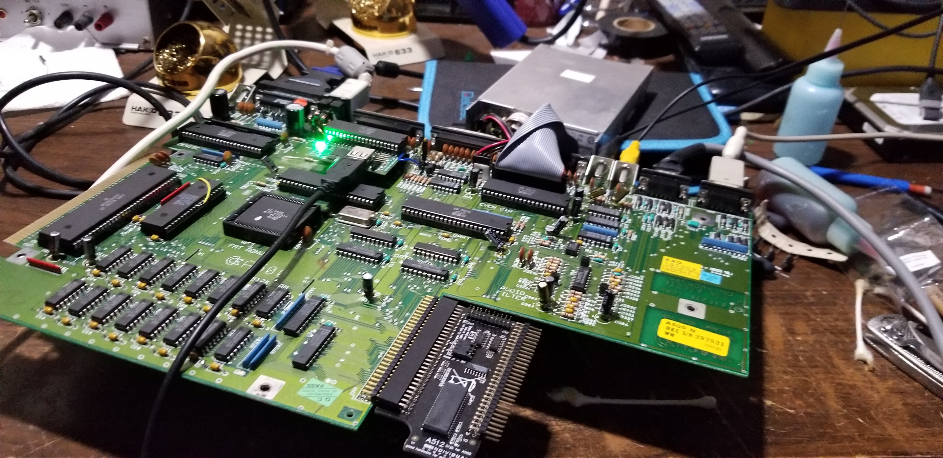

    Well Just a quick update, I should mention I can get a USB keyboard to fully work when plugging it into the RapidRoad USB controller, only issue is it only works on Workbench, if I load up any floppy or WHDLoad game, USB stops working until I exit back into Workbench.
