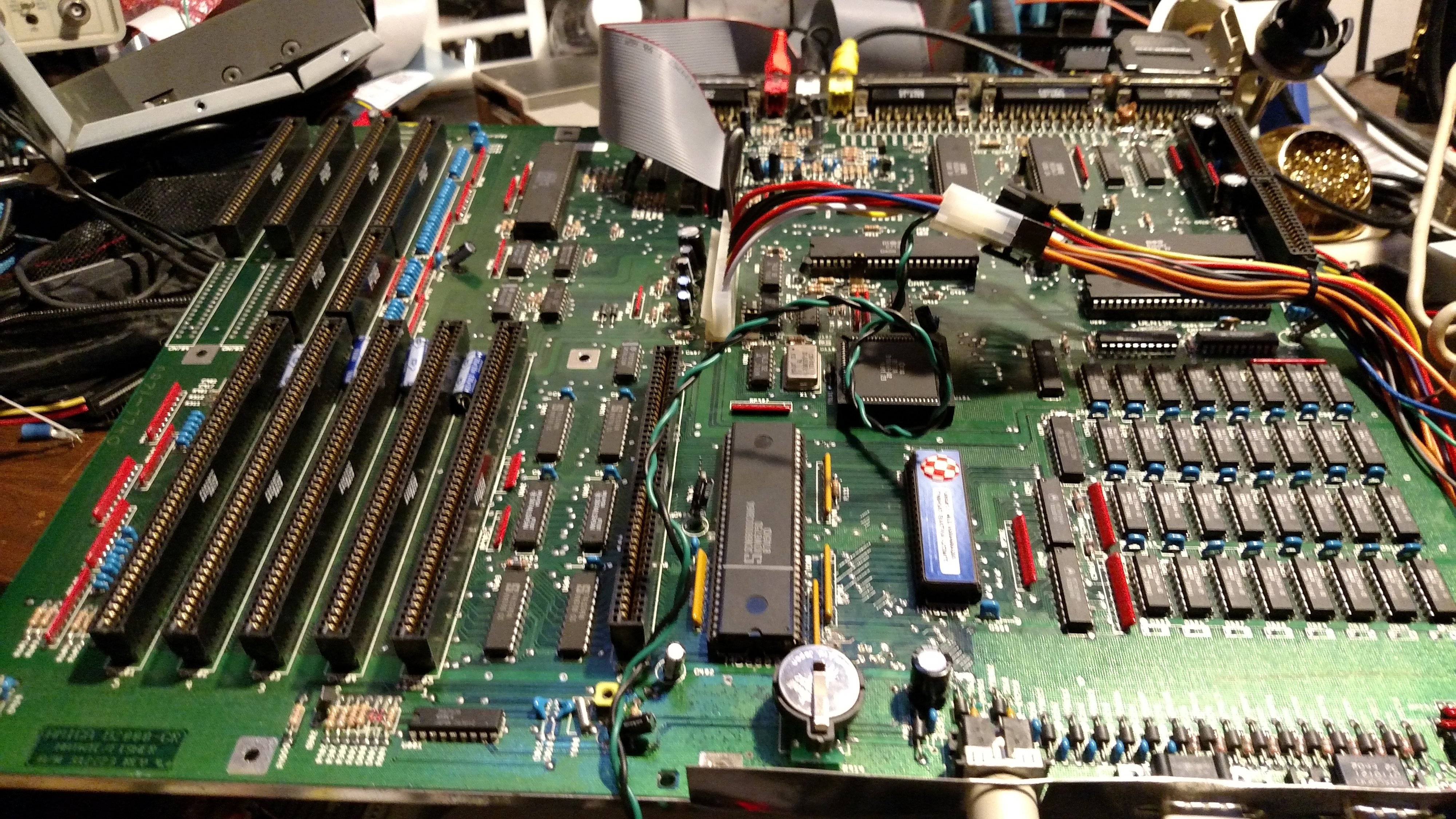

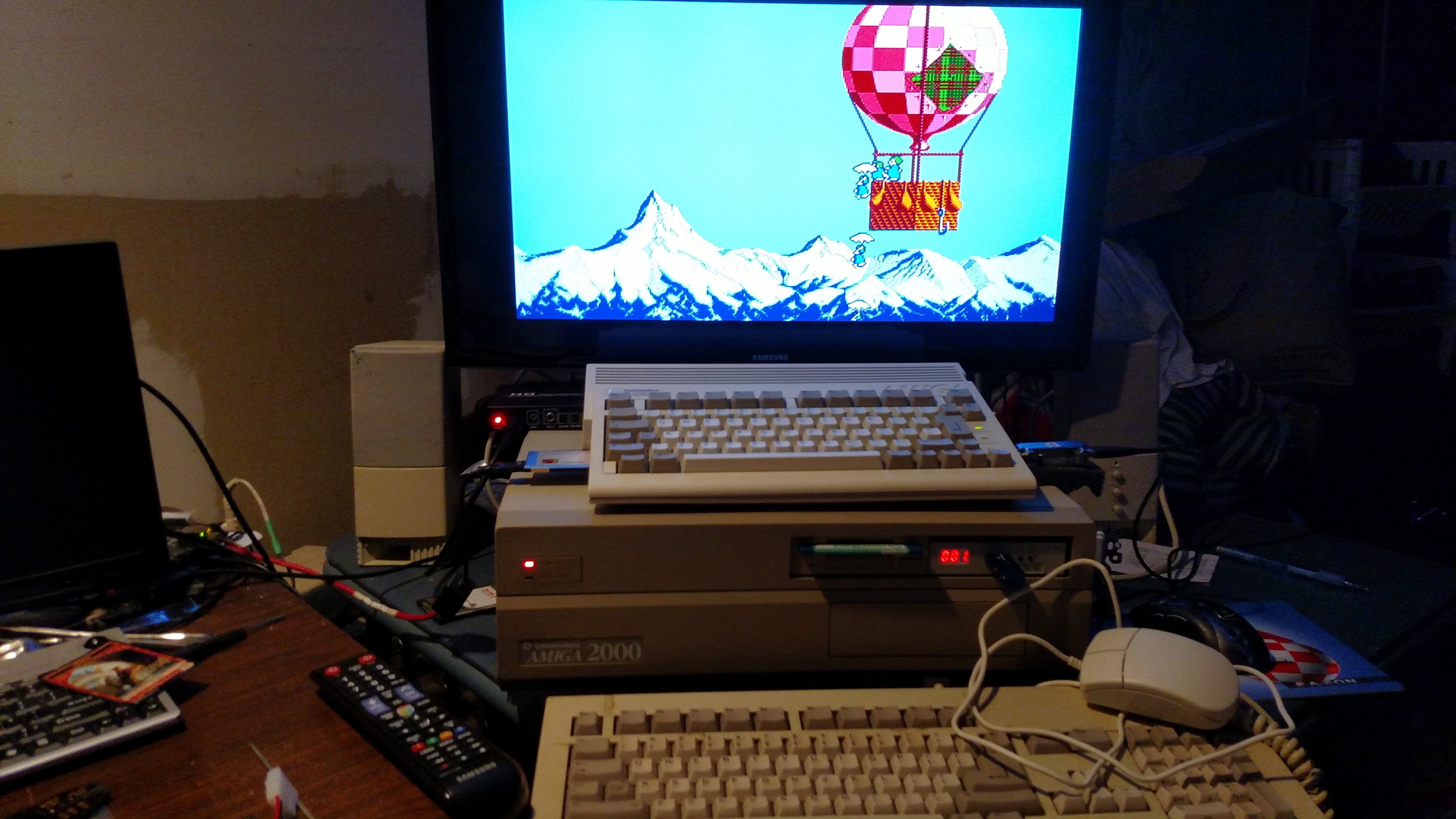

A2000 update!,
Well it's been a slow process but, finally got all the parts, electrolytic capacitors all replaced, double checked all the damaged area in case I forgot anything, repairs looked good. Even replaced the floppy drive connector as someone prior must of been rough on it. Didn't power up, power supply turned it self off the second I turned it on, I did some testing and thought the board may have short or a resistive path to ground. I was contemplated bringing it into work where there was an expensive thermal camera and see if I can see where that may be. But it was too much effort trying to sneak it in and what not.
I ended up talking to someone on IRC and he had a spare board I bought off him for cheap that he claimed worked. Well it got in I tried it out and sure enough It did almost the same thing as my original. So after setting up all my bench supplies to power up the Amiga, I realized my power supply was garbage even though it was fairly new. I get the new PSU yesterday, get the board going, but oddly doesn't have RGB output only the monocrome composite. So I'll most likely need to replace the caps on that board to fix that. However just for a whim as I still think my original board has a short as It failed to power on with my bench supplies, I ended up trying it and sure enough it fires up perfectly, everything works.
So I hacked in the new ATX supply into the old Amiga PSU casing like I did before and we're off.
Repaired Motherboard, new A2K + A600 setup.

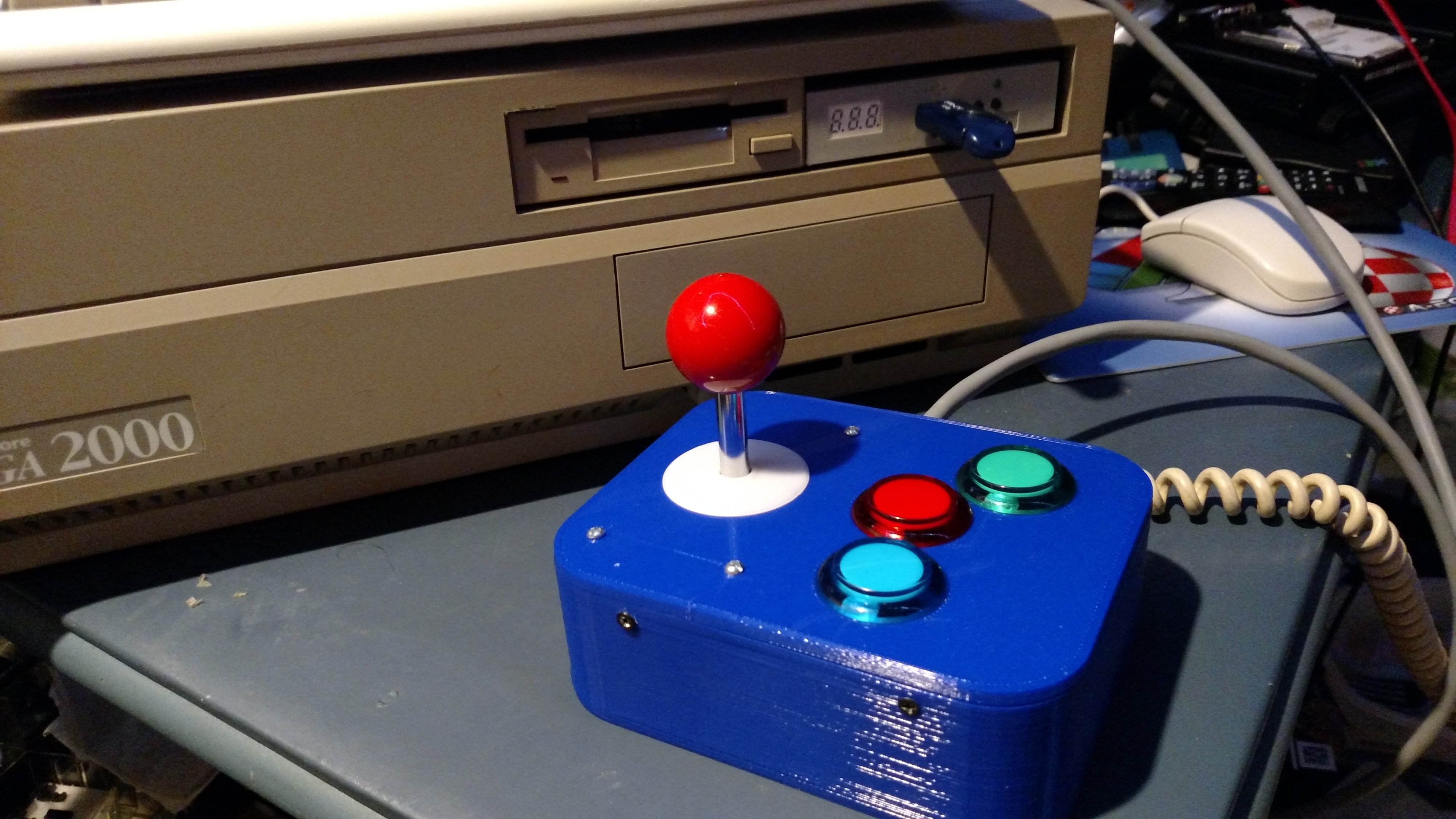

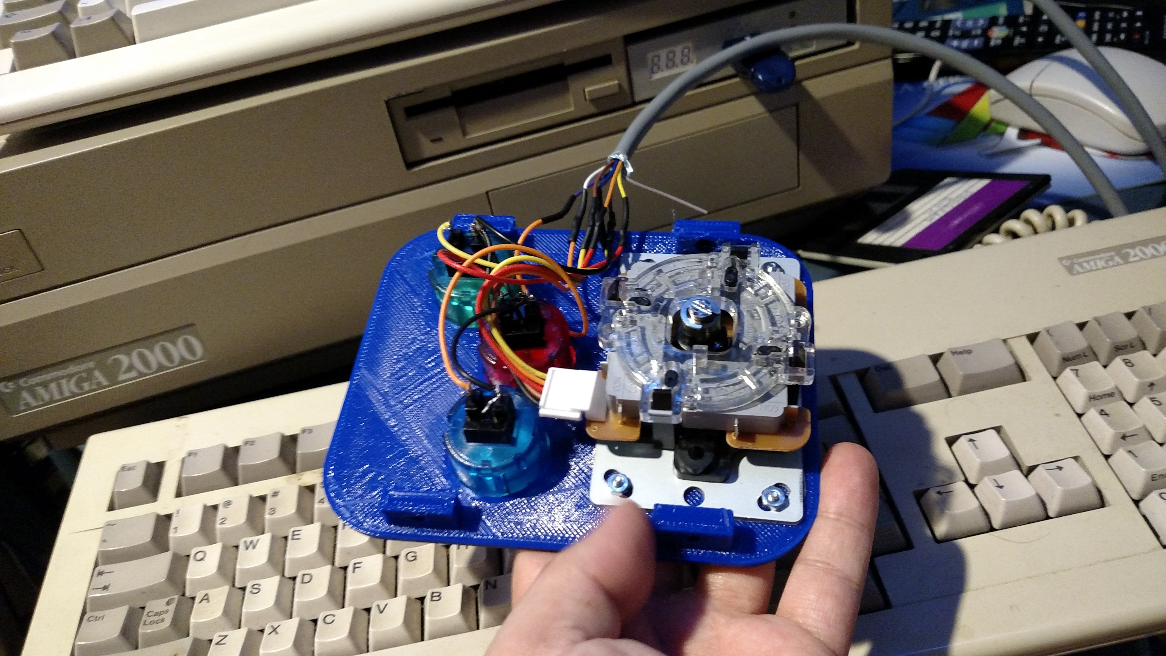

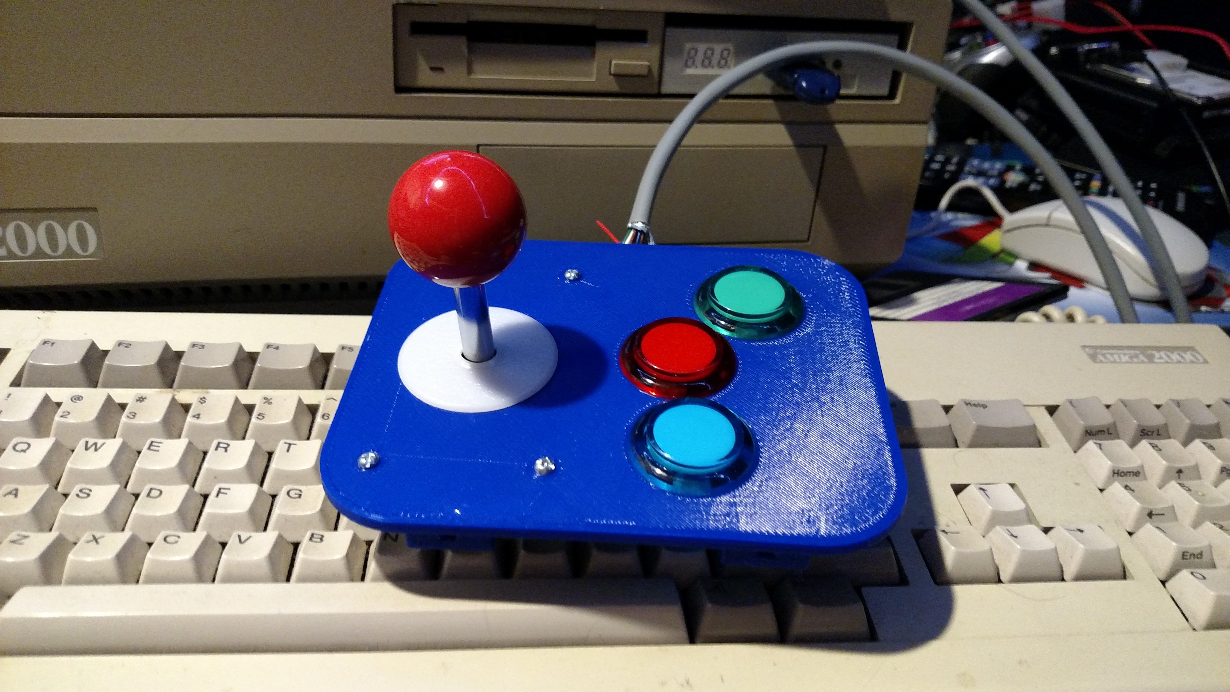

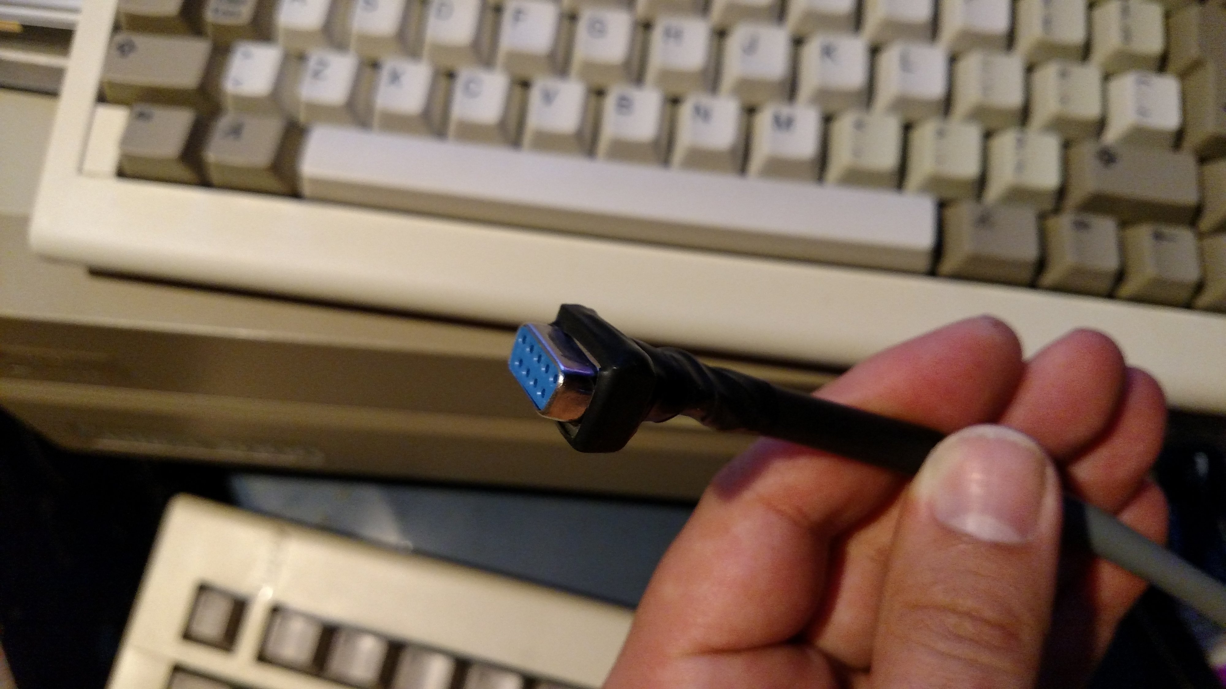

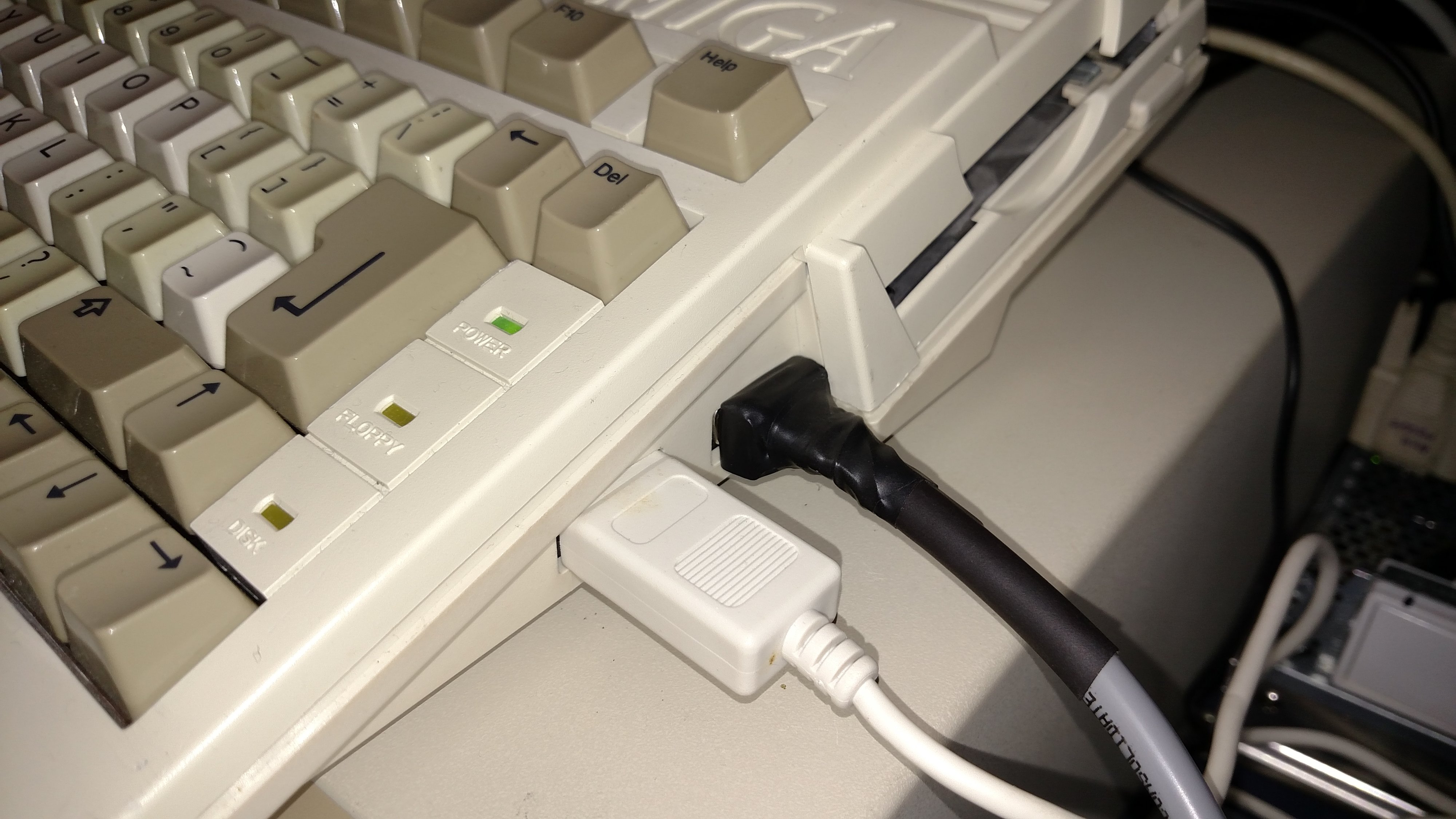

Small easy project, A 3 button Amiga Joystick. Not many games support the 3rd button, but handy for the ones that do. I shrunk down a larger 8 button design I found on the Thingiverse, I'll post up my design one I confirm the bottom part I just barely designed works properly. Another bit of difficulty was making the DB-9 connector to be friendly with the joystick port 2 on the Amiga 600 as the right side of the port is cramped and honestly kind of poorly placed. It was a process of removing the metal shroud, remove the metal back portion on the DB-9 connector, gluing the two plastic pieces together, bending the front metal shroud to it's side and then using hot melt on the wires as kind of a stress release. then covering it with heatshrink and electrical tape as I ran out of my larger stock of it.

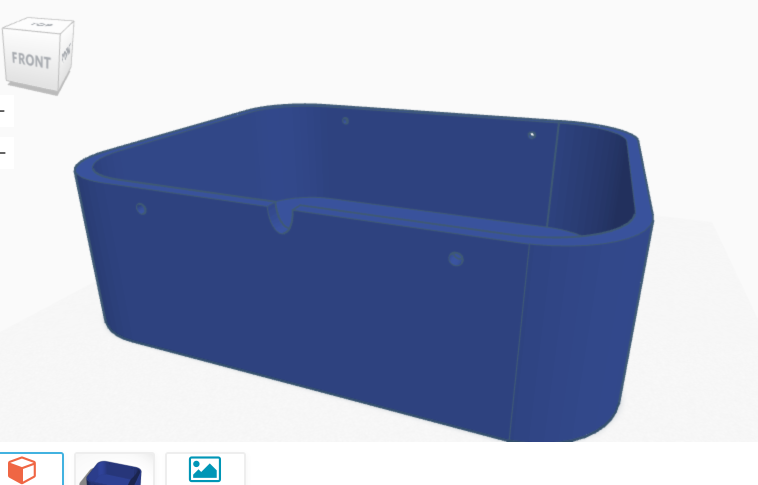

Only thing left is printing the bottom, I just finished designing the bottom portion, shown below.
IMG_20170701_102128381.jpg IMG_20170701_102136857.jpg IMG_20170701_102622640.jpg IMG_20170701_102650715.jpg Screen Shot 2017-07-01 at 2.19.13 PM.png
Oof, that's what happens if they make a DB9 like they make a DB25 with screw in lugs I assume. Most proper joysticks of that vintage had less than 2mm clearance on the left and right. Mind you, they also used cables in the mid 20s AWG (I think), rather than that beefy cable you've got there.
@levi, Yeah that cable is 22 AWG, but 10 wires with shielding and drain ground wire... A little more beefy than needed, but I had it left over from another project.
Minor hack to my Joystick, it was obvious after playing some Turrican 2 that I hate jump being the up direction and not as a button. So I drilled a hole in the back added a SPDT toggle switch to change my third button to be either the true button 3 or act like joystick up.
