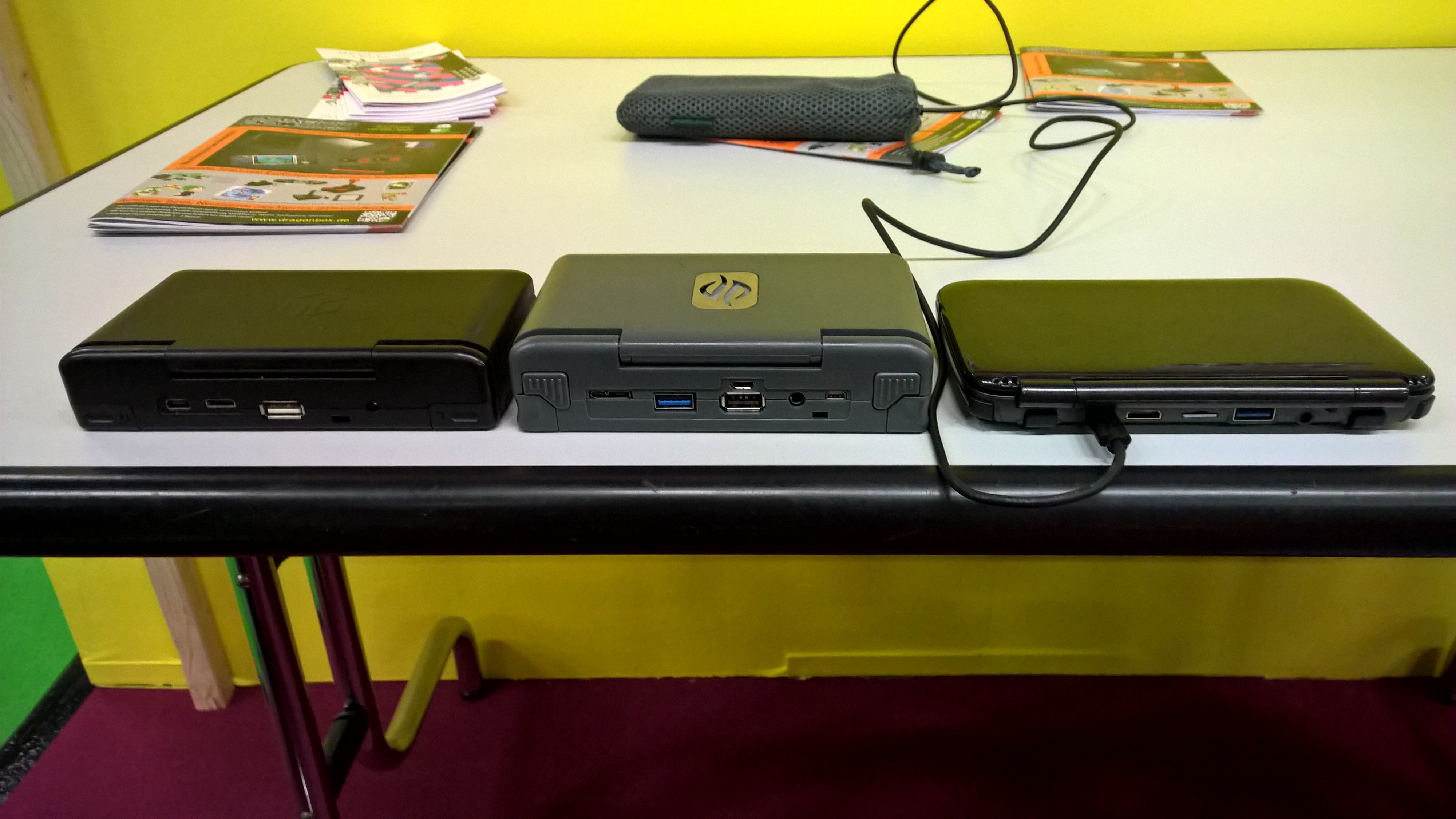

Yeah it was originally going to be a combo port like the one on your laptop, but they stopped making those. So they have to use a USB 3.0 one with eSATA signals on the 5 extra pins, with an adapter to convert it to an actual eSATA port.
Right - which means both of the USB ports are type A. One is using a USB 3.0 type A (blue?) and the other is using a USB 2.0 type A.
But that still doesn't explain why the plastic trim around the port is such a clean rectangle on one and (purposely) wonky on the other.
It took some searching, but I found a great picture in high enough resolution to show the intentional weirdness of this cutout.
groupshot_back-jpg.28927
page-12
https://pyra-handheld.com/boards/threads/test-the-keymat.80259/page-12#post-1419287
The plastics actually stair-step around the corners.
I'm not saying it's wrong - there was clearly some reason for doing this - it is clearly done on purpose. But why?
Looks like a case of dont-cover-any-of-the-port's-metal-rim, but close it up as far as you can as a secondary policy. And if I was so inclined to make an assumption, I'd say, to avoid mechanical conflict, while not being sure, how deep the port will sit. ?
As I say, it's the same on the Pandora, although it's a little hard to see in the black plastic there on the left hand unit. Since they're using the same part for the dedicated 2.0 port, this does expose all of the homing flanges that help you get a plug in and out.
That prototypes plastics seem slightly misaligned with those ports to me, but we know these prototypes were lacking the alignment pins to keep the mainboard in place. Whether the retail units will just have ports dead centre of those holes, or the tolerances of the holes has been tightened up at all since then, we'll just have to see.
page-12
was this the 3D printed case?
No, the 3d printed parts were off white. This was one of the first attempts to get an intentional dark grey I think.
