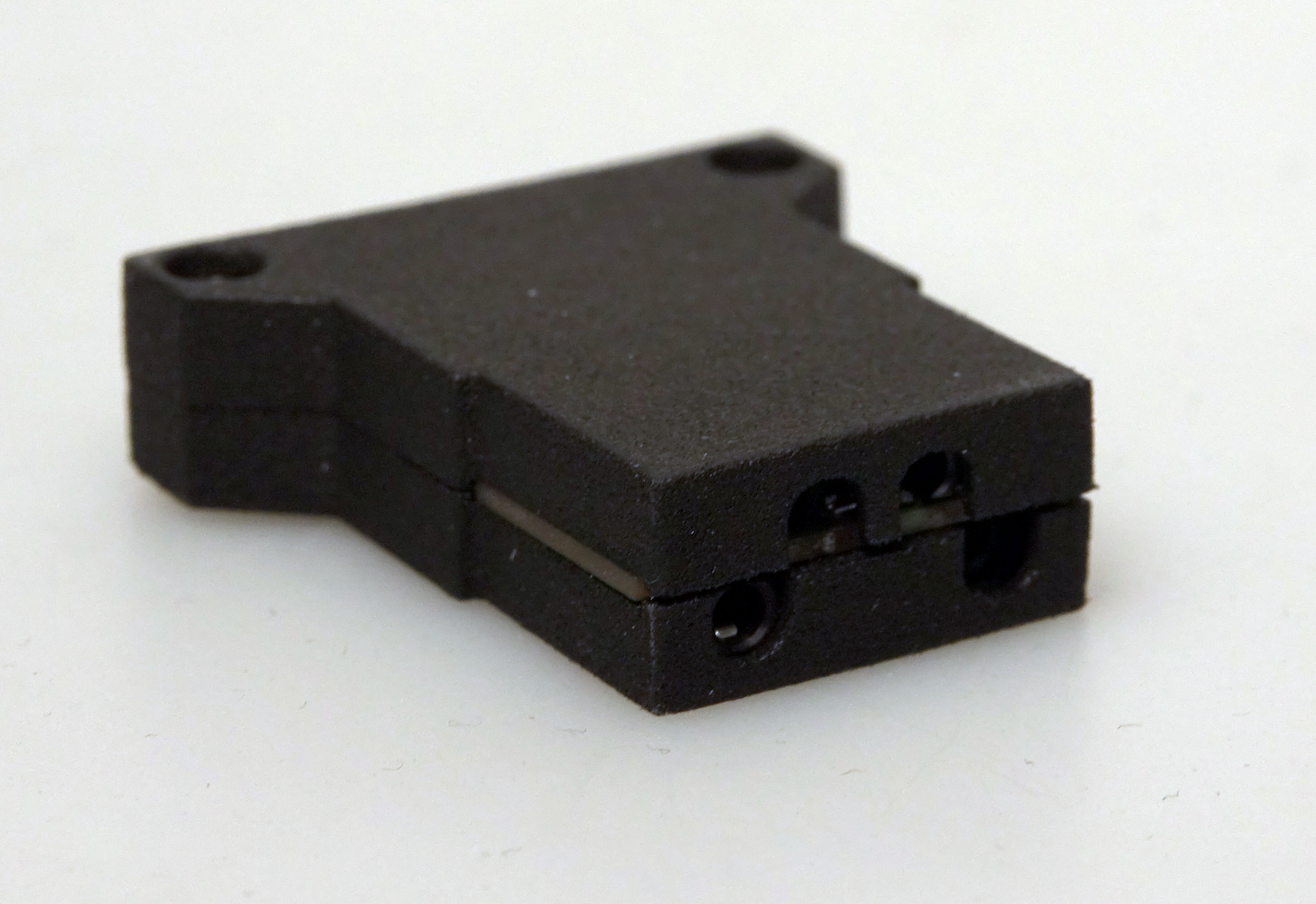

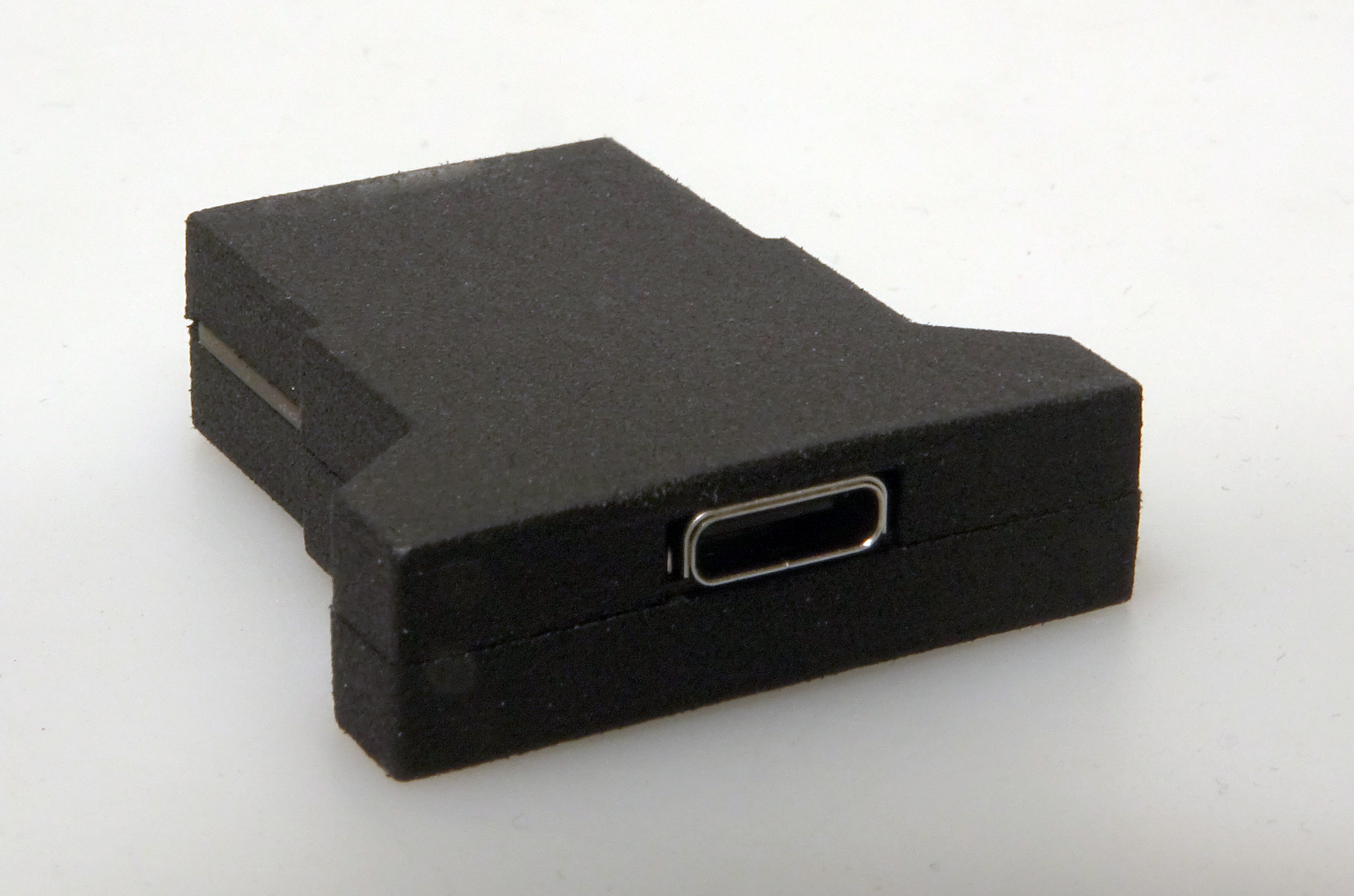

    What is the ColecoPlug?
    The ColecoPlug is a small adapter which you can plug into your original Colecovision (where you usually plug in the original power supply).
    This small plug enables you to use a standard USB-C power supply (like the ones used with smartphones) to power your Colecovision (or any accessories that use the same power supply as well).
    As it's hard these days to find power supplies for the Colecovision, this is a great way to keep your system alive. And it works worldwide, regardless the region!
    How does it work?
    The adapter has an up-converter as well as a voltage stabilizer included.
    It uses the 5V it gets from the USB power supply, stabilizes it and creates stable 5V, -5V and +12V from it which powers the Colecovision.
    As the Colecovision needs quite a bit of power, you need to use a proper USB power supply as well. Any power supply providing 2A or higher should work without any issues.
    Thanks to the voltage stabilized, even cheap USB power supplies that provide less than 5V work fine - but it's still suggested to use a good one.
