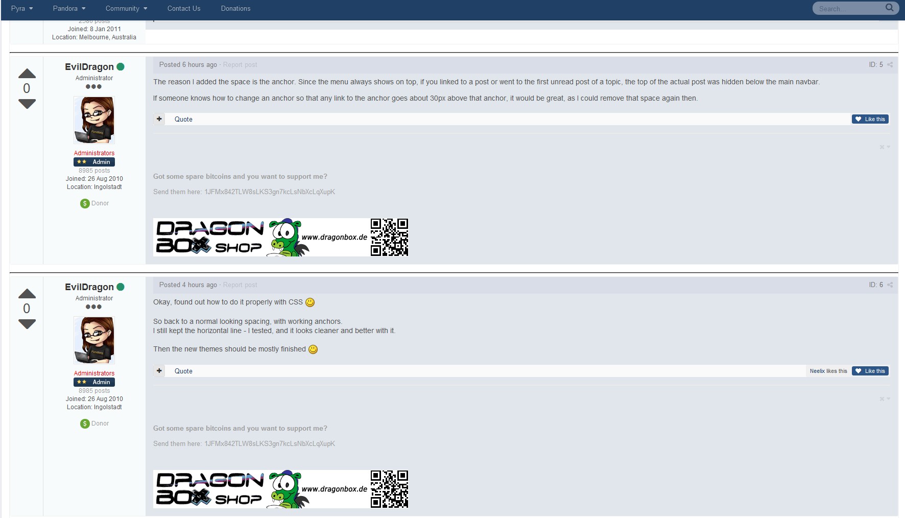

Do you happen to have a backup of the "Pandora Forced Desktop" theme as it was last afternoon? It seems that you've added <br> elements inbetween posts since then, which to work around with CSS would be rather dirty. The same is true for the <hr> elements inbetween posts, so if you could remove those too, then that would be splendid. (This approach is not ideal anyway. By adding separator lines inbetween posts, you just create even more "visual elements", namly the spaces above the lines, the lines themselves, and then more spaces below them. That's why these lines don't really serve their purpose, because unless you increase the empty spaces around them, everything just becomes more busy. Contrast this with the attached screenshot.)

The reason I added the space is the anchor. Since the menu always shows on top, if you linked to a post or went to the first unread post of a topic, the top of the actual post was hidden below the main navbar.
If someone knows how to change an anchor so that any link to the anchor goes about 30px above that anchor, it would be great, as I could remove that space again then.
Okay, found out how to do it properly with CSS :)
So back to a normal looking spacing, with working anchors.
I still kept the horizontal line - I tested, and it looks cleaner and better with it.

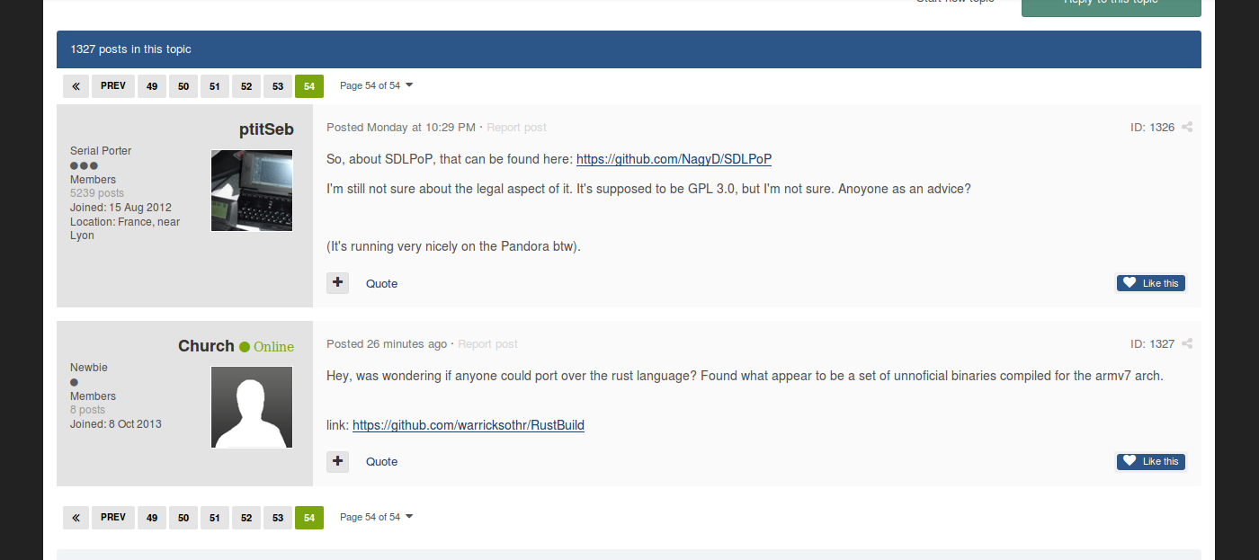

It was already suggested to work with some decent colours instead of such an line. :) separate the background from the post windows a little bit, it does not need much. All it needs is a slight contrast between the posts and the spacing between. Oh, and the color of the post header is to much on the blueish side, I suggest to pick an color from another site element to match it better the light blue and grey colors here are much better imho. ;)
The color of the post header is exactly the same as on the old boards - and the remaining colors now as well :D
I can also add a different color instead of a horizontal line, if you think that's better... don't know which color though.
light blueish grey or anything that makes the posts a little bit lighter or darker - or keep them white and change the colour in between. I guess everything is better than this ugly line. ^^"
Here, quick and dirty mockup, this also dulls the "bright" forum appearence a bit, I don't like plain whige backgrounds:
