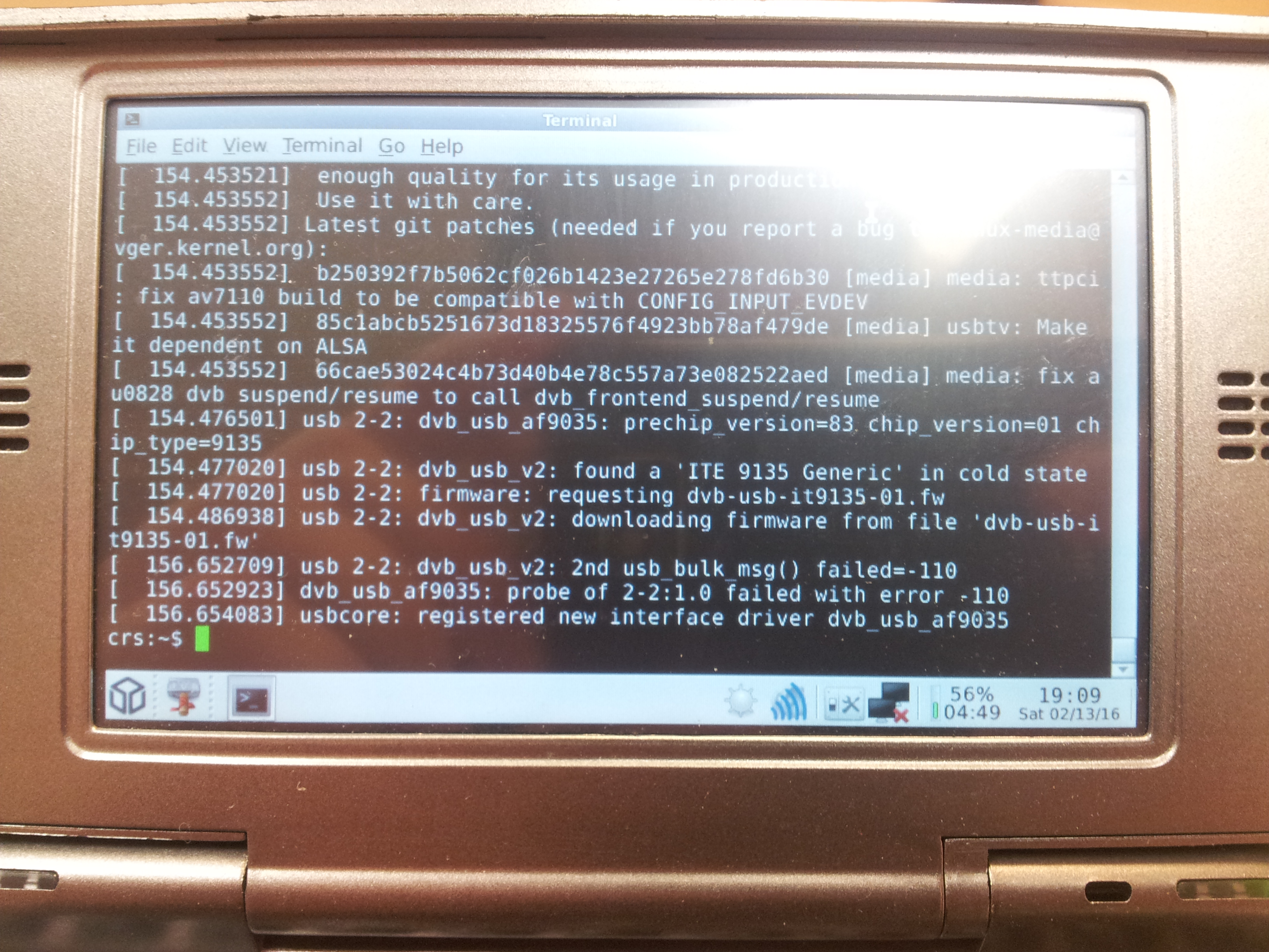

Strange... Was trying to get my dvb-t to work, I had installed all the drivers and it registered fine a few weeks back in dmesg.
Today I finally sat down to generate a channel.conf and test with vlc and I kept getting the attached errors in dmesg.
Literally the only thing that had changed between a few weeks ago and today was the install of android (for that sweet Netflix goodness) which should have no effect (firmware is on nand).
A couple reboots later along with turning USB host on and off and it worked in dmesg, generating Conf files, and in vlc...
Very strange.
It's giving timeout errors, meaning the hardware stops responding. Maybe it's trying to draw too much power from the USB port and when the battery is not full there is not enough supply.
That could be.. I was at 50 something percent. But I didn't recharge between it not working and then working. I'll keep an eye on it next time though
Battery life isn't an issue. If the device attached to USB port draws too much current It will cause the USB Host to stop working. This is a standard protection measure, you will need to use a powered USB 2.0 Hub most likely. In the case of the Pandora if the USB Host crashes, a reboot may be required to get it running again, or well some command line thing I'd prob have to research myself.
