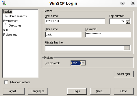

Look up the ip from your Pandora handheld. Use your username and password you entered when you first booted your Pandora. It seems the Pandora is running an SSH server by default.
session host name (i put pandora ip in here ?)
port 22
username (pandora user name)
password (pandora password)
all other settings are at default and when i click on login ,it times out.
do i need to be running something on the pandora ? like software or is there a server running when i boot up the pandora ?
do i need to change some settings in winscp ?

so i am on a local network ,my pandora is 192.168.1.3 ,i put this as host name yes ?
file protocol sftp
port 22
i can't see any options to change anything to (shh).

Try the scp protocol, it's more commonly available than sftp.

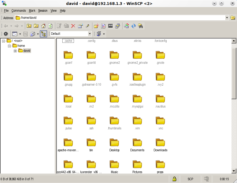

I tried using the program on my Linux computer using Wine, and it worked with these settings when I connected to my server.
If it *still* doesn't work for you, it might be that your router blocks internal network traffic, something which I doubt, but you should check your router settings anyways.
Thank you dflemstr and mindlord ,i managed to connect once i turned my comodo firewall back on and set it up properly to accept ,i had just thought turning it off would be ok ,now i am in ,yippee ! cheers guys.
