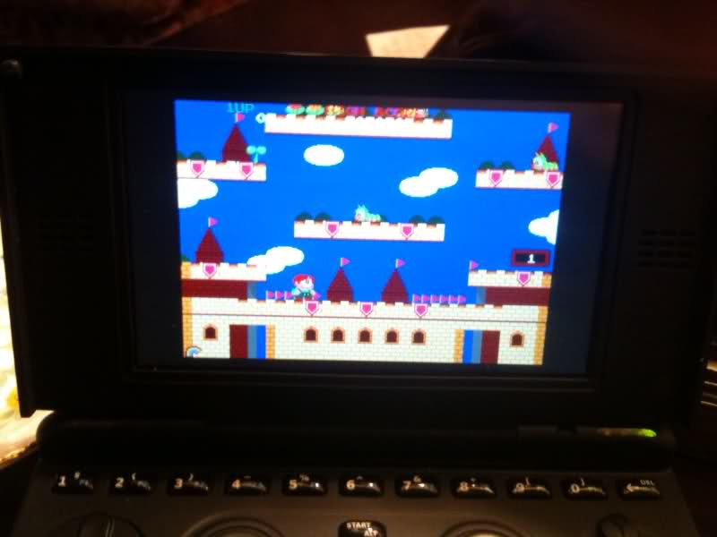

x68000 said:
One for Trooper :D Works fine at 600Mhz
Aahhhh!, Cool, Thanks x68000. :D
