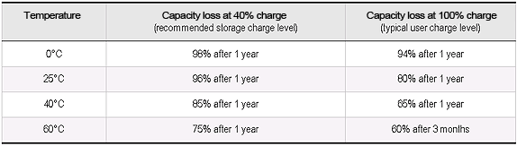

If you store it 100% charged, even in cold conditions, there will still be be significant decay. Someone posted a graphic above, but it doesn't include 15deg celsius or any other temperature close to a refrigerator.
Looking at the figures for storage at 0deg, I was going to say that the difference between 94% and 98% is hardly worth worrying about. But if the estimations in the table hold true over a number of years storage, that difference becomes quite significant.
Charged at 40%, stored in freezer for four years: 92%
Charged at 100%, stored in freezer for four years: 78%
But is that figure the remaining charge when you take it out of the freezer, or the remaining capacity? I'm sure there are plenty of other variables too. Interesting anyway.
Surely they must mean the capacity? If they were talking about remaining charge, 92% of 40% is still a lot less than 78% of 100%, which makes the whole thing kind of pointless. Unless they're talking total charge, in which case I'd say those number are quite spectacular. :)
If your fridge is running at 15deg Celsius then it's a serious health hazzard! Most fridges operate at around 5-6, which is fairly close to the 0 shown on the graphic.
Even if you were storing at 15 degrees, it's safe to assume that the result will be somewhere between the values for 0 and 25 degrees.

Erm, what I meant is that neither 0 or 25 are the normal temperatures of fridges.
And that site says it's bad to put batteries in a freezer.
Dude, if you've left the battery in the freezer for 4 years, it has not served it's purpose at all. Even if you do store it in the freezer for that long, 78% is still a massive charge.
Personally I don't consider a 6% drop per year to be significant in anyway, but that also assumes it's kept at full charge. I'm going to go ahead with the belief that the battery will get occasional use. My opinion stands: if it's an emergency battery, keep it at 100% in an airtight container in the coldest part of your fridge, and it'll keep well enough for years, for the times you actually need it. That way it's ready to go, just got to pull it out and warm it for a for a few minutes.
