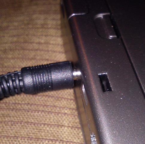

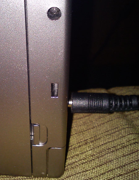

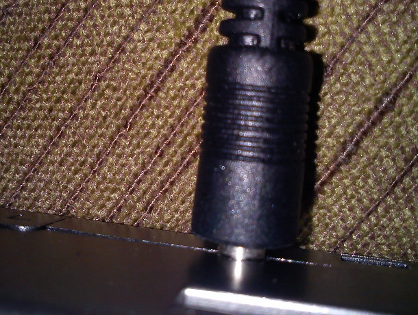

The plug of the charger supplied with mine doesn't sit flush with the case when it's plugged in, but it's not 1cm out.  In fact the charger plug tip is only about 1cm long in total.  It sits about 2mm or so from flush when it's plugged in and charging.  It doesn't have a particularly positive connection - it starts to grab the plug when it's about 3mm inside the bounds of the case, and I then push it in the rest of the way until I hit a very definite stop just before the body of the plug would hit the case.

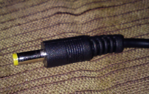

Is the charger one of those that has adapters on the end? If so it could be sent with a wrong one attached. Happened in the past.
Okay here is a few photos of the charger attached, and one of the charger "pin end" itself.  I can usually get it to charge eventually - by constantly turning it around, or pulling it out slightly and putting it back in again - can take 1 min to get a connection, and then about 3 goes or so after I let it go before the red light stays on.  I noticed the actual pin in the Pandora side itself sits over 1cm inside the unit - should it be nearer the hole/case?
