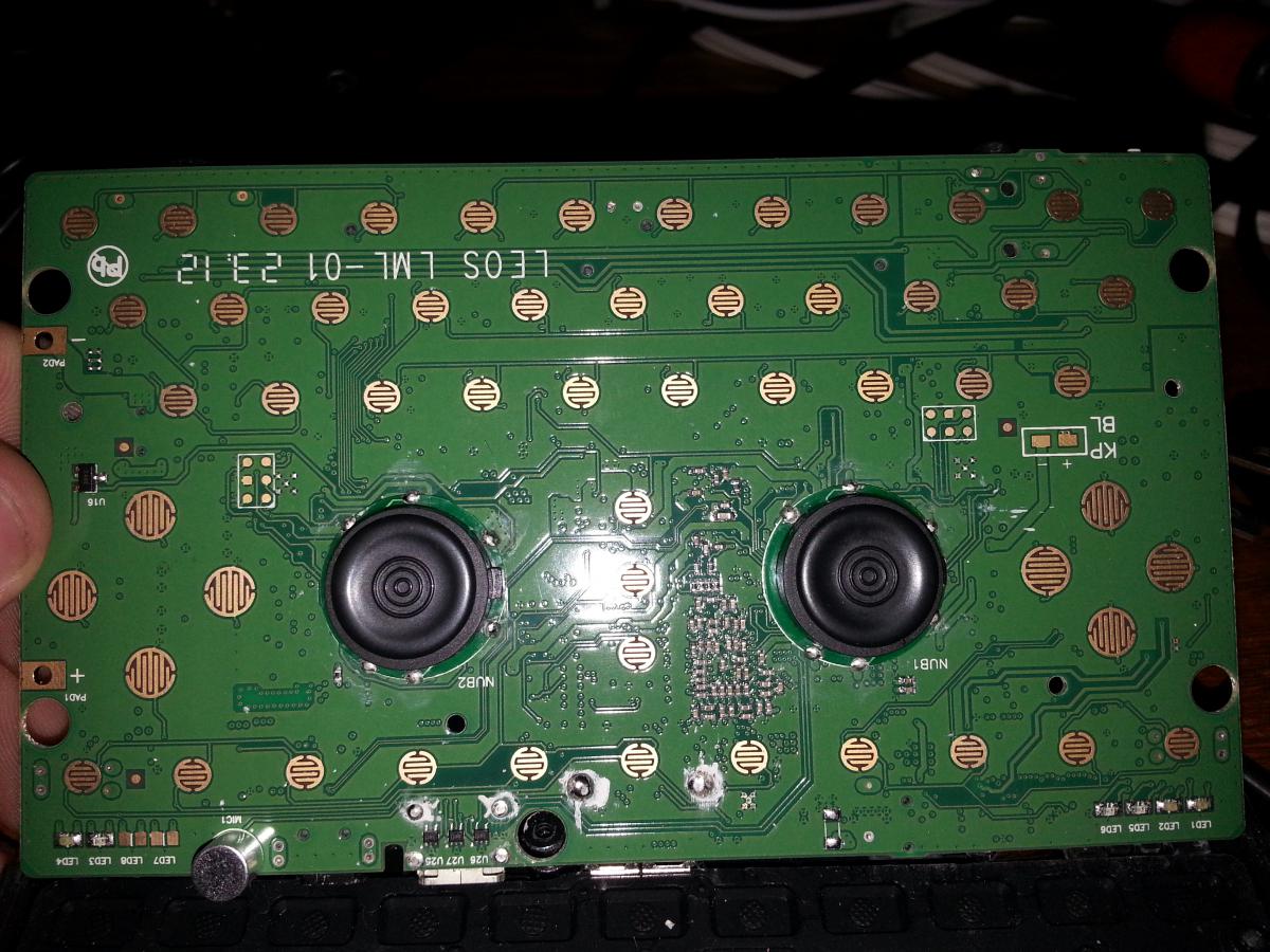

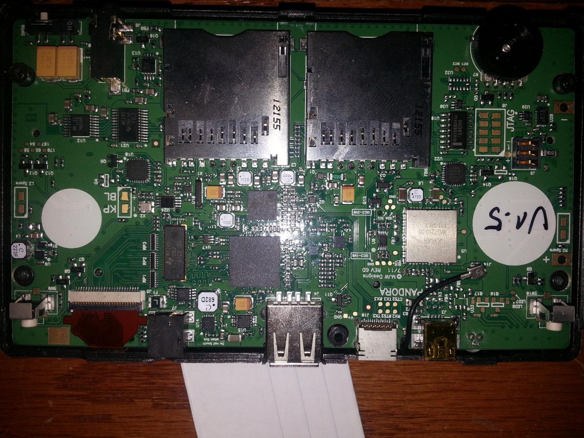

Yeah im willing to give it a shot *goes to find tiny tiny screwdriver*
Edit: so im not sure if I see anything wrong...
