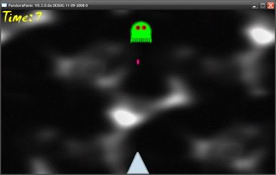

  • If you're starting from scratch, you're ready to go to it! I started out by playing with the SpaceInvaders game to see how things worked, eventually changing pretty much all of it but appreciating the framework it provided. Thanks, pstudio!
