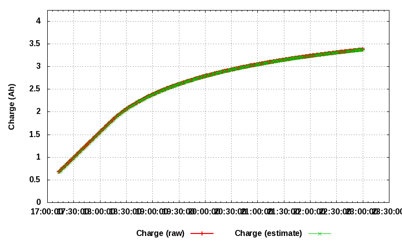

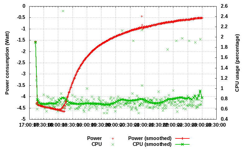

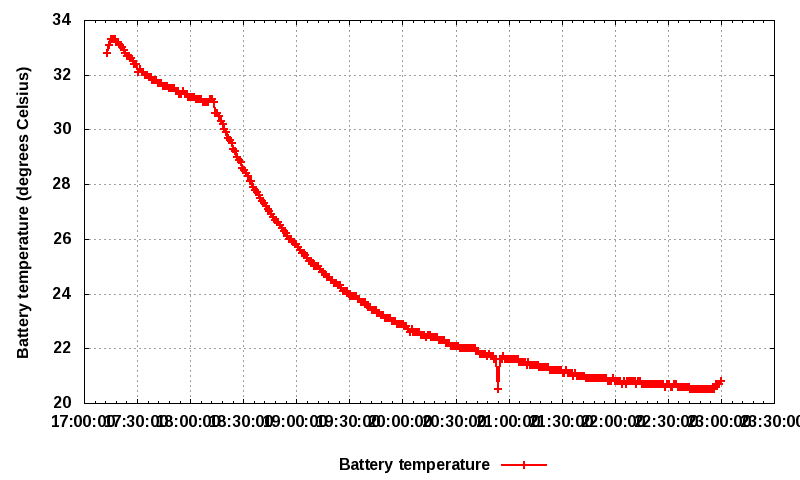

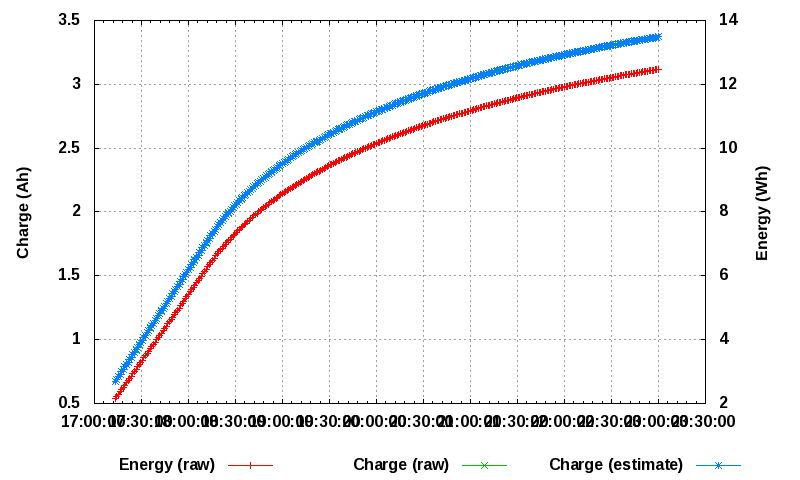

I finaly teseted the log and plot feature and it seems to work great. My goal was to test the battery charging, my battery is not the best and takes a long time to load. I also don't get it over 90% much so I just wanted more details. Not sure about the results but these are the plots of many hours charging from ~20% to ~90%.
Plot-power looks weird, I hope the plots are OK and in line with the usual behaviour. ^^
