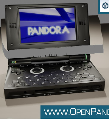

You mean like the link i posted to DaveC render on the previous page, Quoted below.
trooper said:
I managed to find the render that DaveC posted.
Here
I must admit, I did say identical, Though it obviously isn`t. But is was the only clam-shell design posted, Oh and it also has a hint of what you want to achieve. :rolleyes:
Trooper
Trooper
Nifty, but not exactly what I had in mind. I only considered the screen as it is now to be detachable, not mod it with controls or put the entire motherboard behind the screen. Although I can see how DaveC's mod could be a gamer's wet dream, I was only thinking about how to transform the Pandora into a tablet MID.
Obviously, my way would require some smart connector to deal with the mirrored video output, but I think it might be feasible (more or less) with the current hardware.
The more I think about it, the more I think your method is probably the best - I didn't realize until now that your intention wasn't to put the mobo/PCB behind the screen. Outside of designing custom sockets for the two display connectors (the "forward" and "back" ones that would theoretically be part of the lower shell) I can see this working very well. But getting over that specific challenge won't be easy...
Basically (hah! how easily that runs from my fingertips) it's just a connector/connectors that mirror(s) the video, audio and touchscreen cables. The biggest problem I see is how to keep it compact enough to allow the screen to sit more or less flush with the keyboard.
Well, that and the hinge problem, of course. B)
Edit: I have no idea how the connections run in Pandora's hinge, but maybe it would be possible to keep the hinge as is and make a pair of connectors that go into a recess bottom center of the screen. One connector would be for "regular" use, while the other would mirror the leads to the screen for tablet mode. Not the most portable of uses (extra connector to carry), but maybe the easiest to accomplish.
Well in theory, doing a mod like this would require the user to take apart most of the Pandora anyway, so getting them to replace the bottom part of the housing wouldn't be too much more work than the replacing just the top, so making it sit flush is less of an issue since you would just have two pieces to replace, both the top and bottom housing, with matching dimensions.
So basically it would look as now, but after the hinge the lid could be detached and plugged in backwards?
I like it. Way to think outside the box :).
I will post a picture of what I think you mean.
http://picasaweb.google.com/lh/photo/kIWvvvvfDc1unZHj1Hw21A
That is an excellent idea, and in fact might be possible with milled parts (for a small run milled would likely be cheaper, even in aluminum :) )
The trade-offs are excellent, keeping the original hinge as designed, and only adding the small flimsiness of the straight connection afterward. Which could be engineered around, or reverted to the original lid, or have thumbscrews or such.
If unconcerned about looks when using it in tablet mode you wouldn't even need to make a new screen, just cut the lid, mill to fit a connector, and epoxy the new connection into the lid B).
I like the new lid idea as well, if you could add 4-6 face buttons it would be usable as a standard gaming format system too.
Another option would be software to mirror the LCD output, then making the backlight able to flip sides :), make the new lid with a removable panel in the top so that you can use the pen. (I guess you would have to choose which side the touchscreen was on, or add another touch panel.)
Nubie, that's almost exactly what I meant. Like I said, the only big problem I see is that, if you reverse the screen, you'll need a way to mirror the wires and contacts and I can only see that happen with a loose adapter (you're going to need two: one for the screen in the "normal" configuration and one for tablet mode).
I think that for reasons of sturdiness some sort of screwing implement (har har har) would indeed be best (thumbscrews with regular and reversed threads seem like the obvious way to go for easy operation).
A further mod could indeed add a few buttons to the screen lid, although the Newton in its days got away with just one on/off button, and the shoulder buttons are still accessible anyway (they'd make for nice page turning buttons for FBReader of pause/stop buttons for Mplayer.
This could be fun; I'm almost regretting I never went for that engineering degree. As it stands, my construction skills are a bit too clumsy to endeavour such a mod. Now, if the Pandora were made of bricks and mortar, or timber and steel, I'd certainly have a stab at it.
