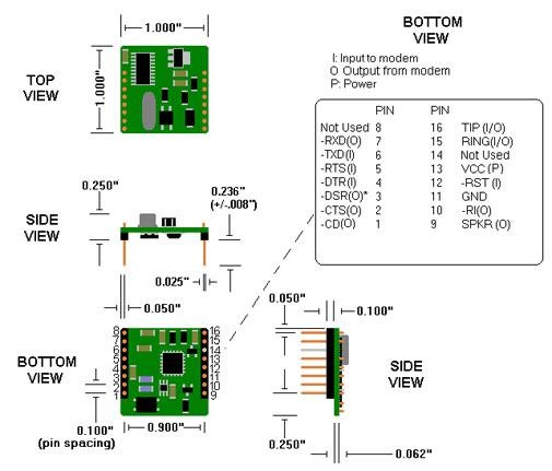

Btw it's seems that this modem can be directly soldered to UART! :rolleyes:
pinouts:
Not Pandora's, not with a "TTL level" interface (which is probably 3.3V but 5V tolerant).. you have to do those things SteveM mentioned.

You'll need to design and manufacture an adaptor board for this if you want it to work. It will need
1. A TXB0104 level converter (will give voltage conversion for RXD,TXD,CTS,RTS - thats what we have on the pandora serial port, other pins you will need to either set to a level or leave N/C... mostly means that you wont have RI input, but its mostly used to wake up devices anyways (eg. you'll still get "RING" on the serial port anyways))
2. A 2.8V to 3.3V boost converter (and its needed accessories)
3. An 1.8V voltage regulator (to supply logic level to one side of the TXB0104).
4. Connectors for everything.
5. Other stuff you want to connect. I read that it has a SPKR output, that might be possible to put into a line-in channel for example...
Power-wise it seems that the ext port should be able to supply enough power for the modem. It has 200mA 2.8V, with 80% conversion efficiency (worst case estimate) that should be >135mA at 3.3V. The modem has maximum current consumption of 78mA, so it should roll...
