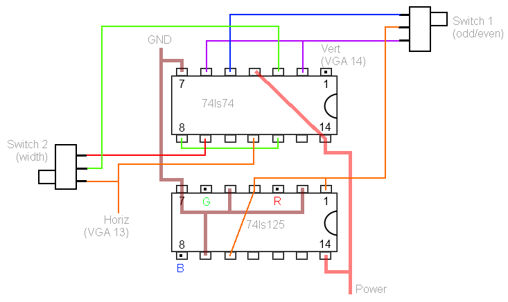

Yes, I was thinking on getting one. Although I wouldn't be able to use with Pandora and that's a pity. Also, as far as I know, ll of them have VGA input/output which some TV-sets doesn't have.
What I find quite fun is that SLG3000 is kinda old and can only do 640x480 res, where some of the DIY I linked can work on higher res…
Nope. S-Video and composite video are shitty signals that are a pain in the ass to work with.
The hardware scanline generators I know are always using VGA.
What I'm sure, is that dishing 48,97€ in a SLG3000 is far too overpriced when you can make that  SLG-Width-2.gif for a few bucks… (it generate scanlines and you can adapt the width of those scanlines if you're using a larger res than 640x480)
