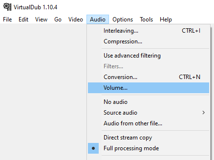

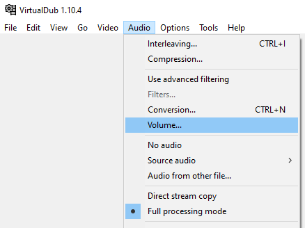

It should. You can select that video is just untouched (video: direct stream copy), only audio processing should be done (audio: full processing mode).UPDATE: so anyways when i play my video on the gp32. It seems to be a bit quiet. Is there any way to increase the volume of the video file in virtualdub? thanks for helping me out with the gp32 in 2025 =-)
Thank you for the response, im trying to experiment wioth the volume settings right now. + can a 16 mb Smartmediacard hold a show or two for the gp32? Just wondering. Thanks and have a great day.If I remember correctly Virtuadub has a weird way of expressing the amplification factor, instead of decibel you directly provide the multiplier.
I think you should try 5.5, and lower that value if it's clipping (1.0 = current level, so values are between min=2 and max=8).
well last time i tried it. it did not show me anything about changing the amp factor. can you show me what version of virtualdub you used and how do i change the amp factor for my videos on the gp32? Thanks and have a wonderful day.If I remember correctly Virtuadub has a weird way of expressing the amplification factor, instead of decibel you directly provide the multiplier.
okay thanks for the response.I just downloaded the latest version, there it's here:
