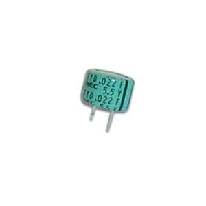

It would have to be a big capacitor, or you would have to change the battery in nanoseconds unless the only thing you providing power for is the RTC because I was thinking more along the lines of getting a battery warning, then closing the shell to put the thing in sleep mode, changing the battery and then carrying on where you left of. I'd very much doubt a capacitor would be able to store enough charge for that in the space we have.
For 49 cents each in batches of 1000:
22000 microfarads. 5.5v DC. 0.45"Dia. x 0.30"Tall.
