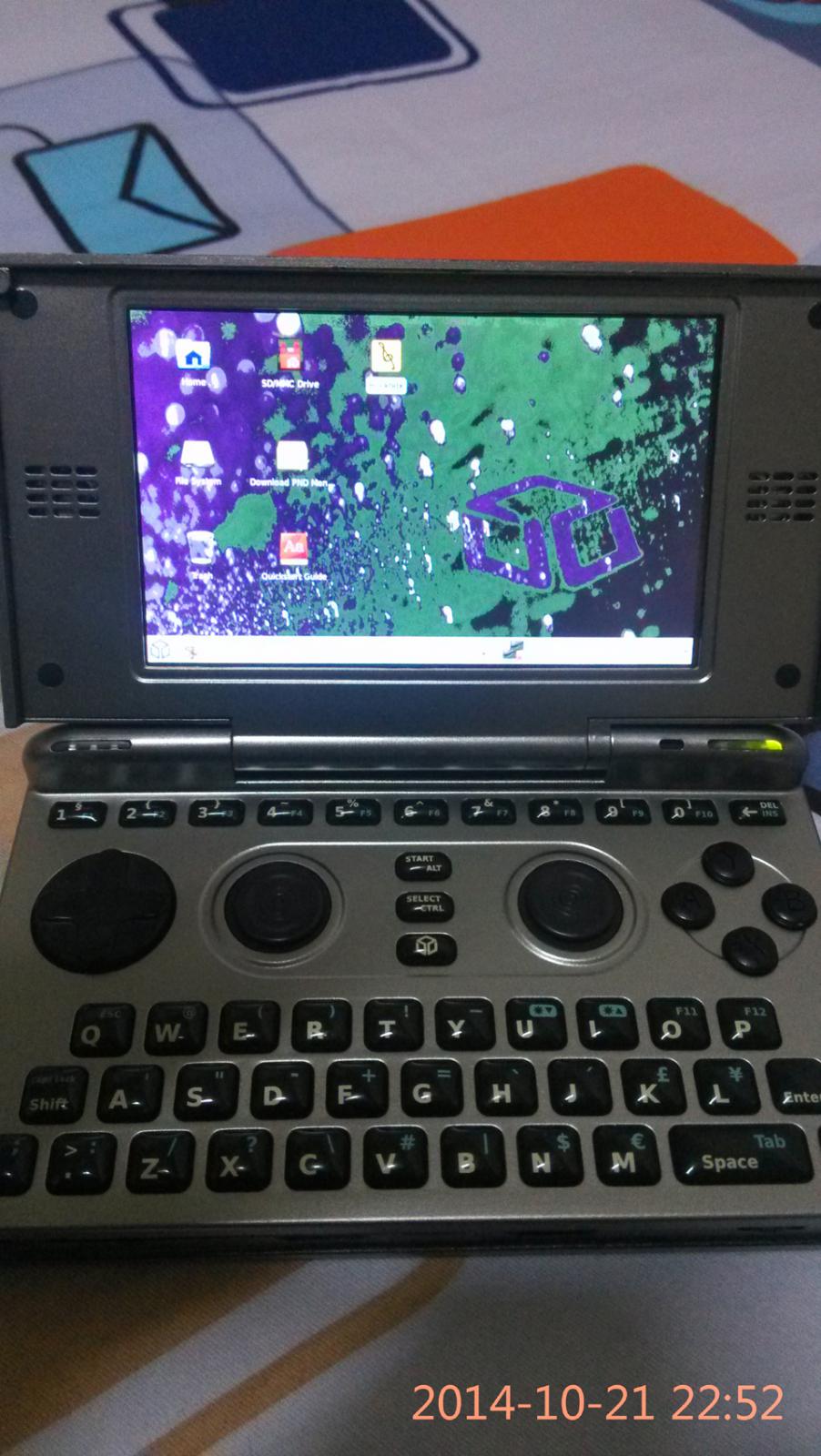

the classic version of the pandora lcd turned purple.
until what is not displayed.
i opened it and found the lcd screen cable broken.
my friend gave me a 1ghz lcd screen wire.
i'm on it for replacement but found not the same slot screen wire.
i can't repair it for me pandora is dead.

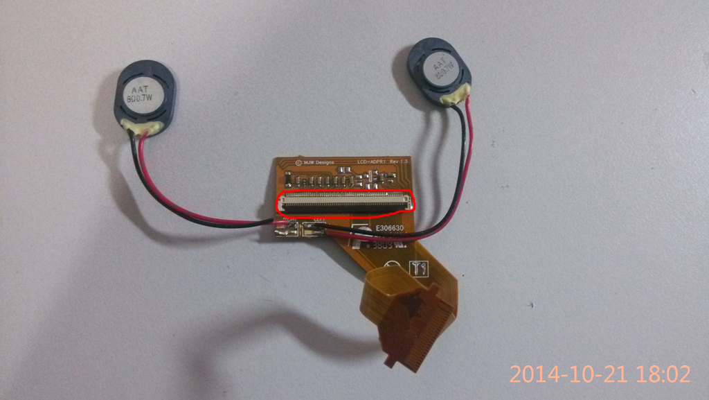

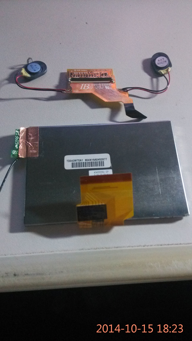

Can you take a photo of the cable and the connector?
hey,everybody is good!
i shot the photos.
the first picture is the original lcd cable and screen machine.
the second picture red circle where,in the lcd can not connect.
the interface is smal.
i shot the photos.
That never has changed, it even is the exact same connector from the same manufacturer.
It HAS to fit :)
Can you make a picture showing it doesn't fit?

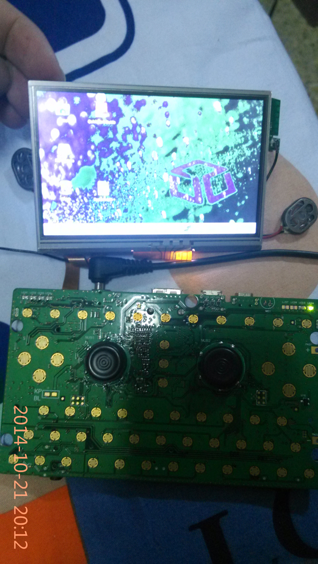

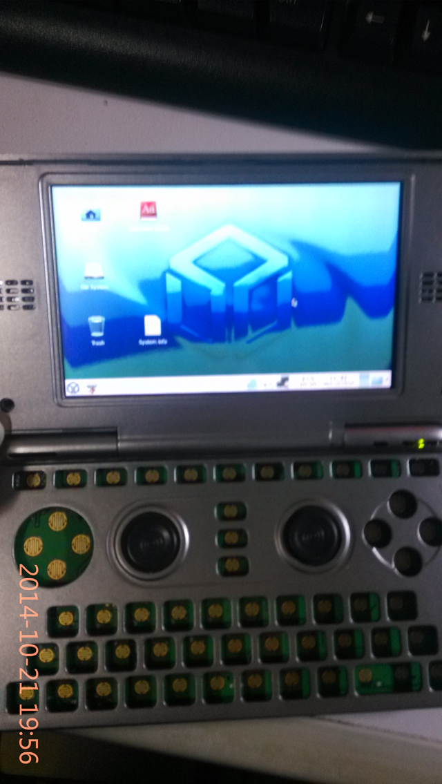

tell you agood news.
cable finally street lcd.
but i got the biue screen.
i was very depressed,pandora is really bad.
maybe lcd is broken, i got a blue screen.
Did you make sure that the cable is properly seated in the connector(s) ? This is often the cause for colors beeing "off".
This looks like either improperly seated cable or cable broke during assembly (were you careful?)
Does the cable look damaged, or do the results change when you wiggle the cable around?
Also, you want to remove the date-setting on your camera. It is hardcoded onto the images. Since the date seems to be set on the camera, the right information is embedded in the metadata of the image anyhow.
I'm sure I correct installation of cable.
But the screen is still blue.
I should be estimated LCD screen is broken.

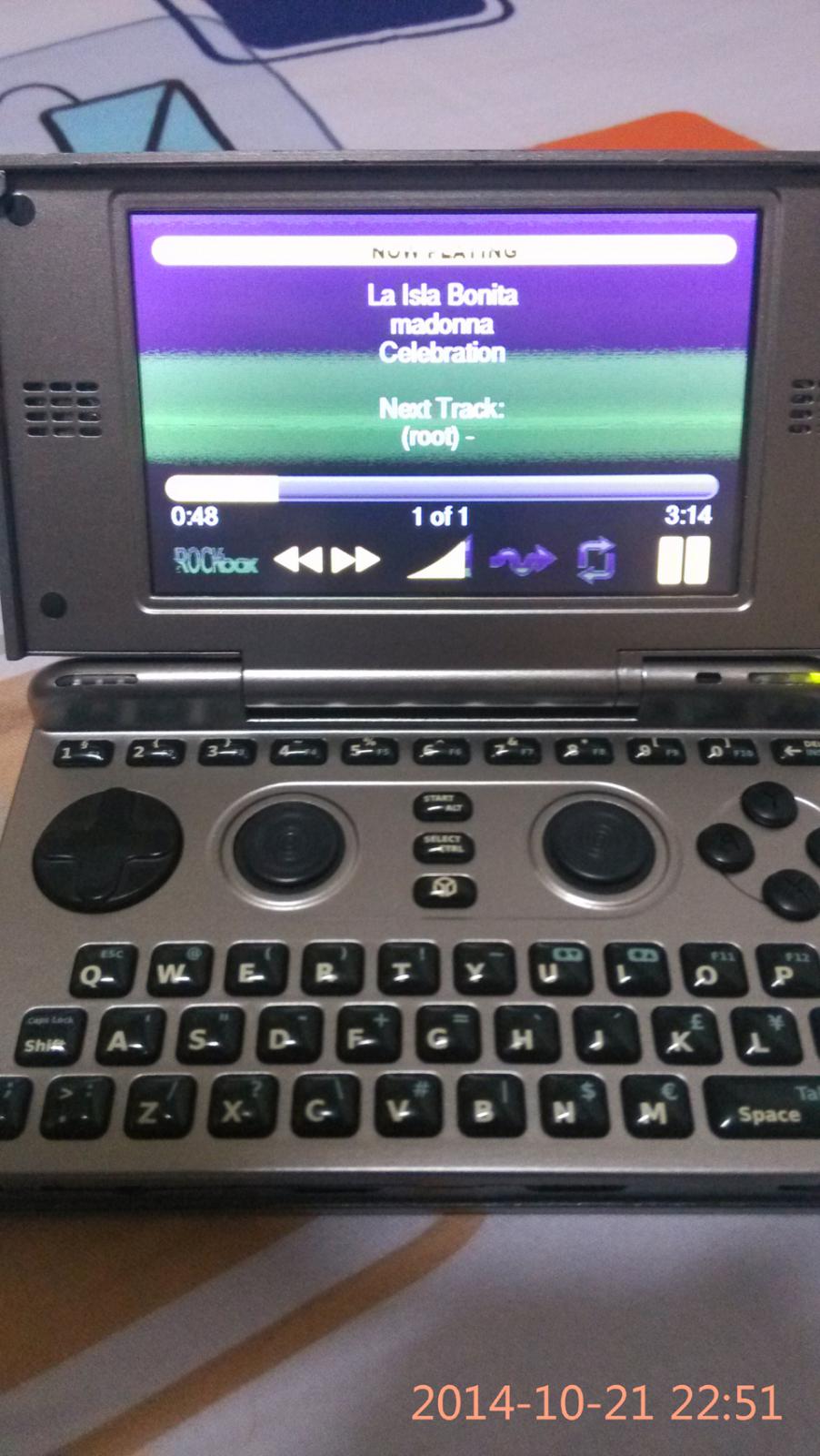

I had just assembled Pandora. At least it is not black.
But the screen color is not normal. Now I can only use it to listen to music.
That looks like an LCD cable issue to me.
So: Nope, you didn't insert it correctly or you broke it during assembly.
