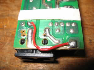

Yes, stick to name brand adapters from someone you trust. We tested some cheap Chinese PSP adapter knock offs to see what we would get and they are a nightmare. Some of them have no internal fusing which is why people end up with house fires and burnt up equipment. There's no way they actually passed any UL testing with the crummy designs I have seen.
Some of them have such terrible regulation, the voltage jumps all over the place under moderate load from the Pandora. I couldn't even imagine turning on Wifi and pulling 500mA from the USB host port at the same time.
5V @ 2A is all you will ever need from an adapter because the Pandora circuitry won't allow more than that to be drawn (actually 1.8A).
They're especially bad if you order them off of amazon or ebay. Usually if you get them online they seem to be poorly made by an amateur.
We need to have a sticky or some major notice saying if you use one of these and you blow up your Pandora it's your own fault, there is some serious shit out there and the CE marks are fake.

Like this?
CODE
http://www.electricstuff.co.uk/acadapter.html
QUOTE
On the underside, an apparently damaged track has been wired across, however further inspection reveals that the track cut is intentional, as without it, the input fuse would be bypassed..!
QUOTE
Opening it up reveals a rather smaller PSU board than expected, plus a bundle of metal strips whose sole purpose is to add weight. Withou these the unit feels very light and 'cheap'...
QUOTE
Although the mains connector is 3-pin, the earth pin is unconnected.

Like this?
CODE
:blink:
Now that's scary !
