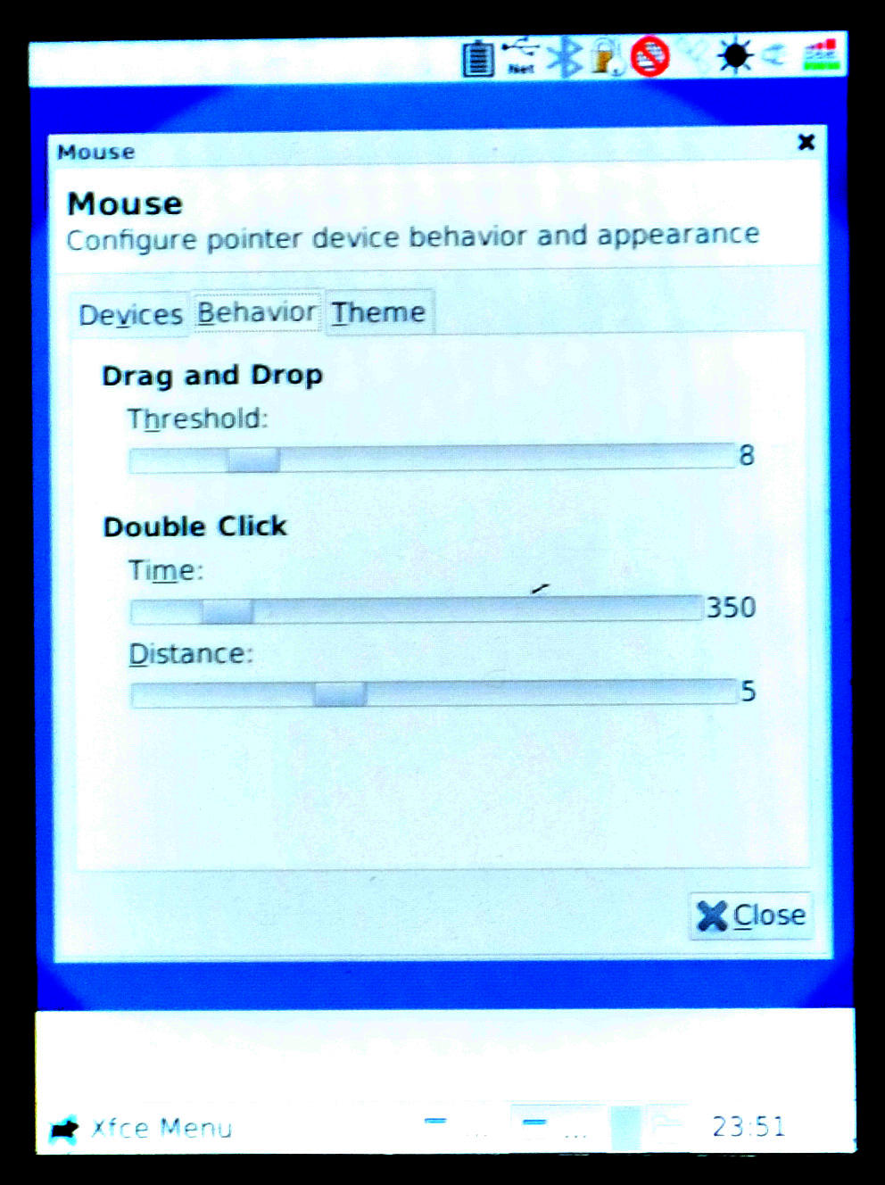

Regarding the double-tap issue, I'm using xfce on an openmoko freerunner phone and xfce has a setting concerning double-tap which is the acceptable radius (in number of pixels) that the second tap must fall into to actually be considered a second tap so this is definitely configurable. Also, the interval between taps is something that you can also configure, ex. the second tap has to come no longer than 250ms after the first one to be considered as a second tap, otherwise it is considered as another first tap. I hope this explanation puts some more concerns to rest (unless it was explained so badly as to cause more confusion :P )
Offhand, where's this setting?

It is under XFCE Menu ---> Settings ---> Mouse ---> Behaviour tab. Obviously since its a touchscreen here you will be changing the stylus settings :)
EDIT:
Drag and drop is the time interval for xfce to realise that a drag/drop operation should start (point and hold).
Double click is the time interval until a second click is valid as such.
Distance is the maximum number of pixels the stylus can stray to still have a valid second click.
