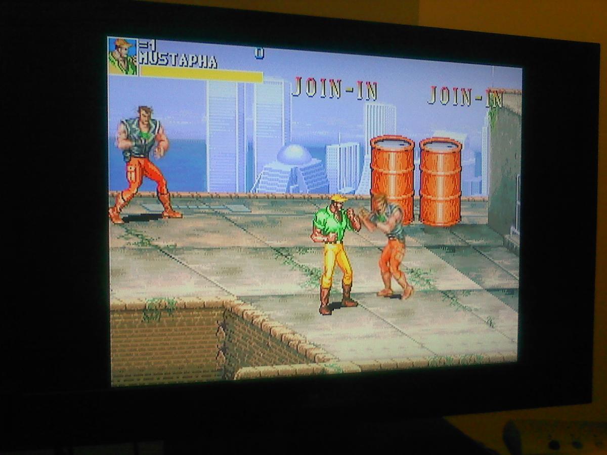

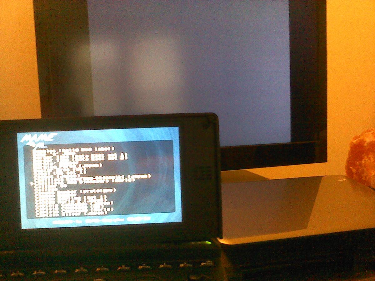

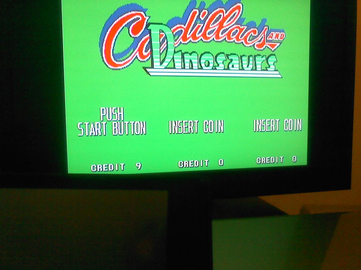

i can get mame 4all working
have 512 pandora running SZ final kernel 3.2 using Composite Cable
1st open tv-out config and i set to composite ntsc main layer and leave the window open
2nd then run mame 4 all it will show on pandora and tv will be blank
3rd pick a game and get it running
4th hit the pandora button and set to hw scaler/ overlay and click write settings
5th click the mame icon on your toolbar to get control over it and will turn pandora's screen dark

You rock !!!! Installed Panmame to play Mame, but this trick is great !!
