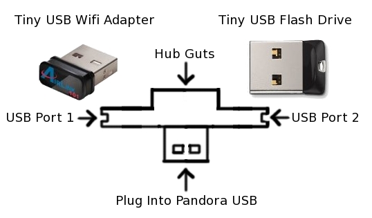

AirLink101 AWLL5088 Wireless Ultra Adapter
16GB SanDisk Cruzer Fit Flash Drive
Hopefully the picture I attached will actually show up...I was thinking of jury-rigging a 2 port hub together that would plug into the back of the pandora and allow me to attach two micro-sized usb devices(the above wifi adapter and flash drive would be awesome together). Ideally, it would be flush with the back of the Pandora itself, and small enough that it wouldn't fall out or block the shoulder buttons. The video cable port might be blocked, but I was thinking of this as an on-the-go solution to include better wifi and extra storage in one fell swoop. The tricky part will be rigging up some kind of case so the unit can plug in flush with the Pandora(since i'd basically just be transplanting the hub guts into a new case).
I've tried finding something that might be similar online to use instead or as a good starting point, say for a laptop or something, but so far I haven't seen anything that matches what i'm wanting. Does anyone have any leads on such a hub?
I doubt that a single USB port can provide sufficient power for both a WiFi adapter and a flash drive without some external power source.
