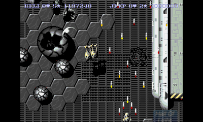

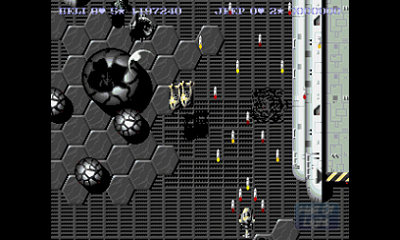

Some pictures to illustrate the problems of the Pandora's screen for Amiga games (for people who don't know much about Amiga games).
1) Games using the full PAL resolution of 320x256 pixels, like e.g. SWIV, Superfrog, etc. are cutoff when pixels are just doubled:
By either stretching the 320x256-pixel original to use the 480 pixels height or shrinking the 640x512-pixel doubled screen to 480 pixels height (and stretching/shrinking by the same amount horizontally to keep aspect ratio) it'd look like this:

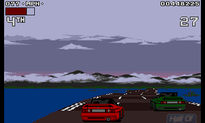

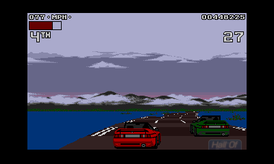

2) Games using only 320x200 pixels, like e.g. Lotus, Hunter, Stunt Car Racer, Wings, etc., which are quasi in "widescreen" 16:10-format (they always had black bars on top and bottom of normal 4:3-screens):
A lot of unused space here. So let's just scale the 320x200 pixels up to 384x240 pixels (if the screen resolution is set to 400x240) or let's stretch the 640x400 pixels to 768x480 pixels (if the screen resolution is set to 800x480):
In this case the bars on the side are so thin one could even opt to stretch to use the full screen width which would almost make no difference for aspect-ratio.
