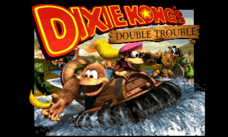

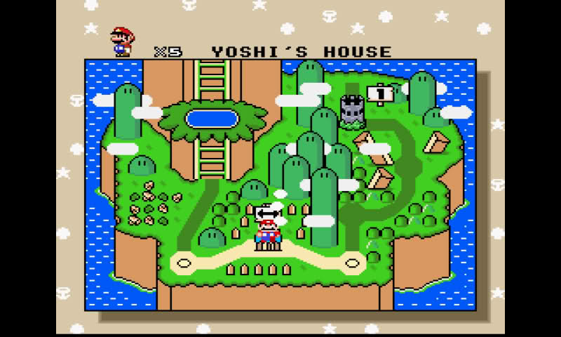

Well, I used MS Paint to "scale" the images.
Just to show screen dimensions. With proper hardware-scaling the results will look much better.
Still some of us may prefer a small border than fuzzy ripply images.
There should probably be a per game config file anyway as other settings like clock speed, button setup other things could be set. If a scale option was there the user could set per app depending on it's native res.
If someone wanted to play with an app like lightwave or deluxe paint you wouldn't want to be stretching text and menus on a 640 x 400 screen you could want 1:1.
This looks good for scaling SNES to a 4:3 ratio. Simple 2X integer scaled the image, then bilinear stretch it to 640 x 480. Don't need this for other consoles that have matching 4:3 ratio resolutions. Perhaps Amiga could benefit from this?
Here's another:
Save these images to your SD card and try them out on your Pandora, see how it looks ;)
